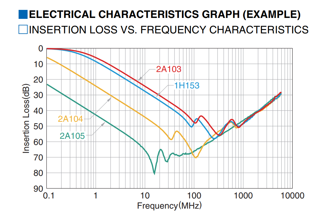

While the design [Bybee Music Rails] was kept confidential for many years, now I know it to be an advanced form of cap multiplier, with no real voltage reference, but with a very low output impedance and VERY LOW NOISE (for a regulator).
It appears to me to be a capacitance multiplier where the emitter follower is replaced by a unity gain opamp voltage follower. The output/input noise+ripple+junk attenuation ratio is set by the opamp PSRR and the amount of (passive) filtering between the DC input and the follower input.
For the latter, let me recommend the 3-terminal SMD feedthru capacitors made by TDK: This one is 1.0 microfarad, 100 volts, and has lots of insertion loss (teal curve 2A105). Use it in the final stage of your multistage passive filter, between DCin and OpampVin+.
