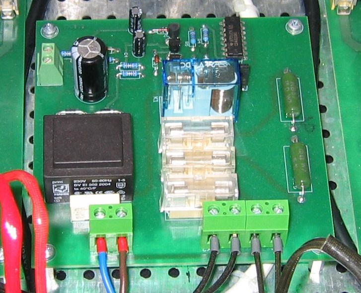

Job for a uC and a Triac in my book!
It might be quite a fun little project to implement a phase locked loop in software, on a uC, using integer arithmetic. Once you've got that, it would be a relatively low cost addition to independently control (phase at turn-on) and (phase at turn-off). Then you could create the best case or the worst case transformer residual core flux, by setting the turn-off phase angle just right.
I always turn my big transformers on through a 10 Ohm NTC (Ametherm) which then gets shorted out after a few hundred ms by a relay. The caps charging up are also nasty.
I started to play with a controller plus trial solution but never too’ it any further. Maybe something for the future.
There was a plot somewhere (Rod Elliot ?) showing 200A peaks on a big linear supply for the first few cycles.
(I use an ARM uC for all this stuff - LPC1114 SMD version 28 pin https://www.nxp.com/docs/en/data-sheet/LPC111X.pdf)
Resistors + logic + relay here.

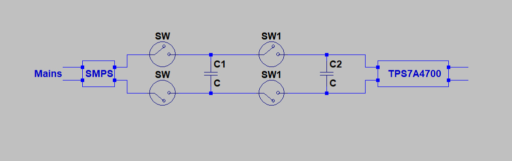

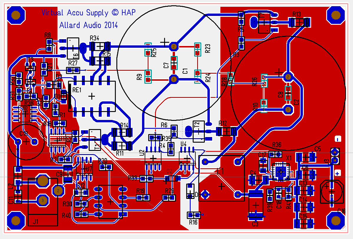

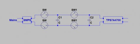

For a transimpedance Head Amp I'm using a two step power supply, an external 5V USB battery power pack, followed by a low noise LT6234 on board regulator, one for each channel.
For my DAC, Preamp and Phono preamp I'm using a three stage power supply scheme, where I start with a Wall Wart SMPS.
Next step is a "Virtual Accu Supply" consisting of switches loading caps, see image below.
C1 is loaded with SW closed, then SW opens disconnecting C1 from the input, and C2 is loaded from C1 by closing SW1.
SW1 opens and SW closes again and so on at a rate of a very low 10Hz, below the audio range.
Steering of the Mosfet switches is performed with a small PIC12C uController that also prevents large inrush currents at start up.
The third stage are on board controllers.
It's quite a bit, but I just liked to bring this idea to life as a technical challenge and it works already perfectly full time for 5 years.
Replacing the VAS by real batteries gives no noticeable difference in sound and also the noise from the DAC, Preamp and Phono amp show no single sign of the Wall Wart switching frequency, just as with batteries.
