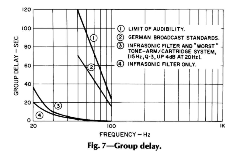

For interest sake, here is a graphic from the Holman article on this subject. Note the y axis should read milliseconds and not seconds.
An LTspice sim of an all active RIAA only introduces about 10us GD at LF - it increases to > 240 us at very high frequencies (MHz).
I was quite concerned about this issue because my RIAA includes a 40 dB/decade HPF - but the GD is low single digit ms at 20 Hz when switched in ie not an issue.
