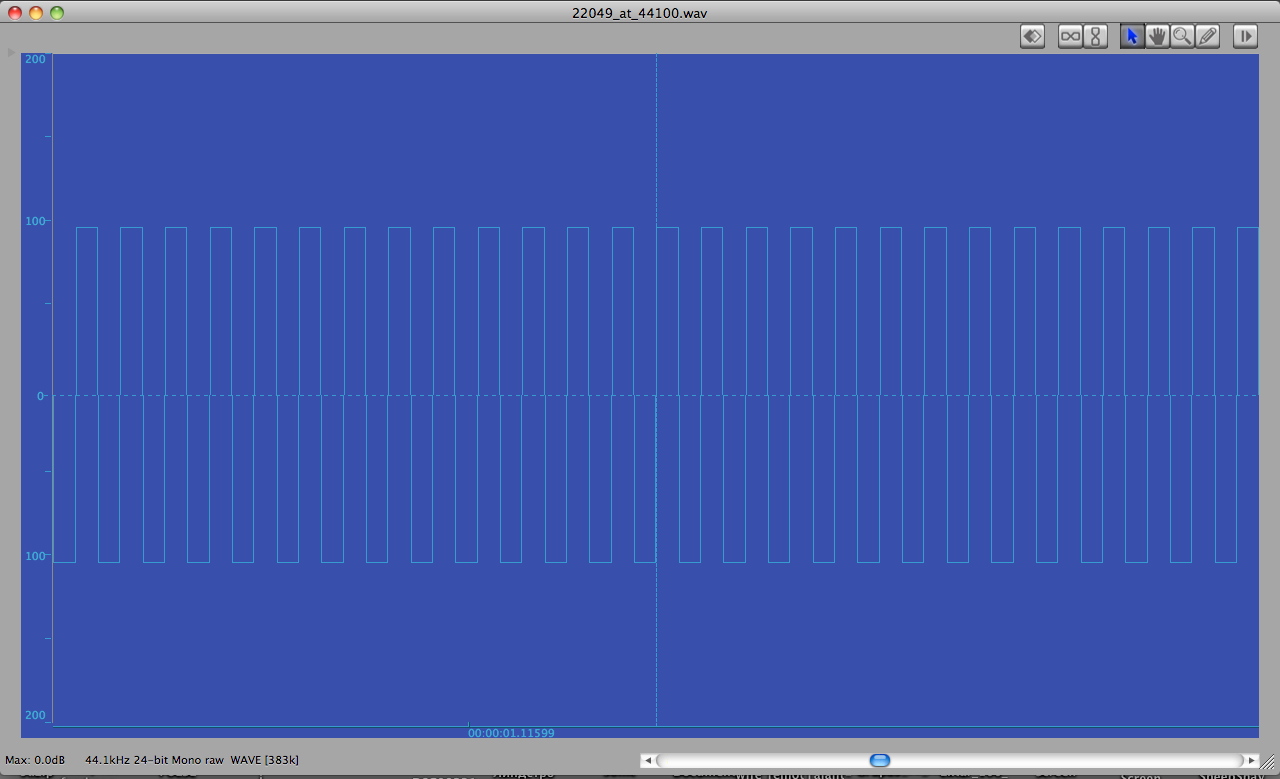

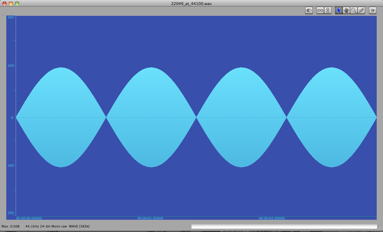

This one might be somewhat related..
Inspired by Scott's suggestion that FFTs should be taken at exact number of bins the sample rate is, I tried to trick FFT analyzers that I have in my DAWs by generating the test files at odd (65536 kHz) frequencies with test tones being at f/2. Guess what - none of the generators that I have were able to produce test tones at exactly the fs/2! No problem with tones at fs/2 + 1Hz or fs/2 - 1Hz, though.
Anyway, to cut the long story short, this is how a sine tones offset by 1 Hz from fs/2 look in time domain - some strange AM! Is this aliasing? (I assume that there is some built-in filter in the generator).
Pictures show 3 sec snippet fully zoomed out and 22049 kHz signal fully zoomed in.
I'd love to hear what you think guys.
P.S Test files are zipped wavs at "regular" 44.1k, not some odd frequencies.
