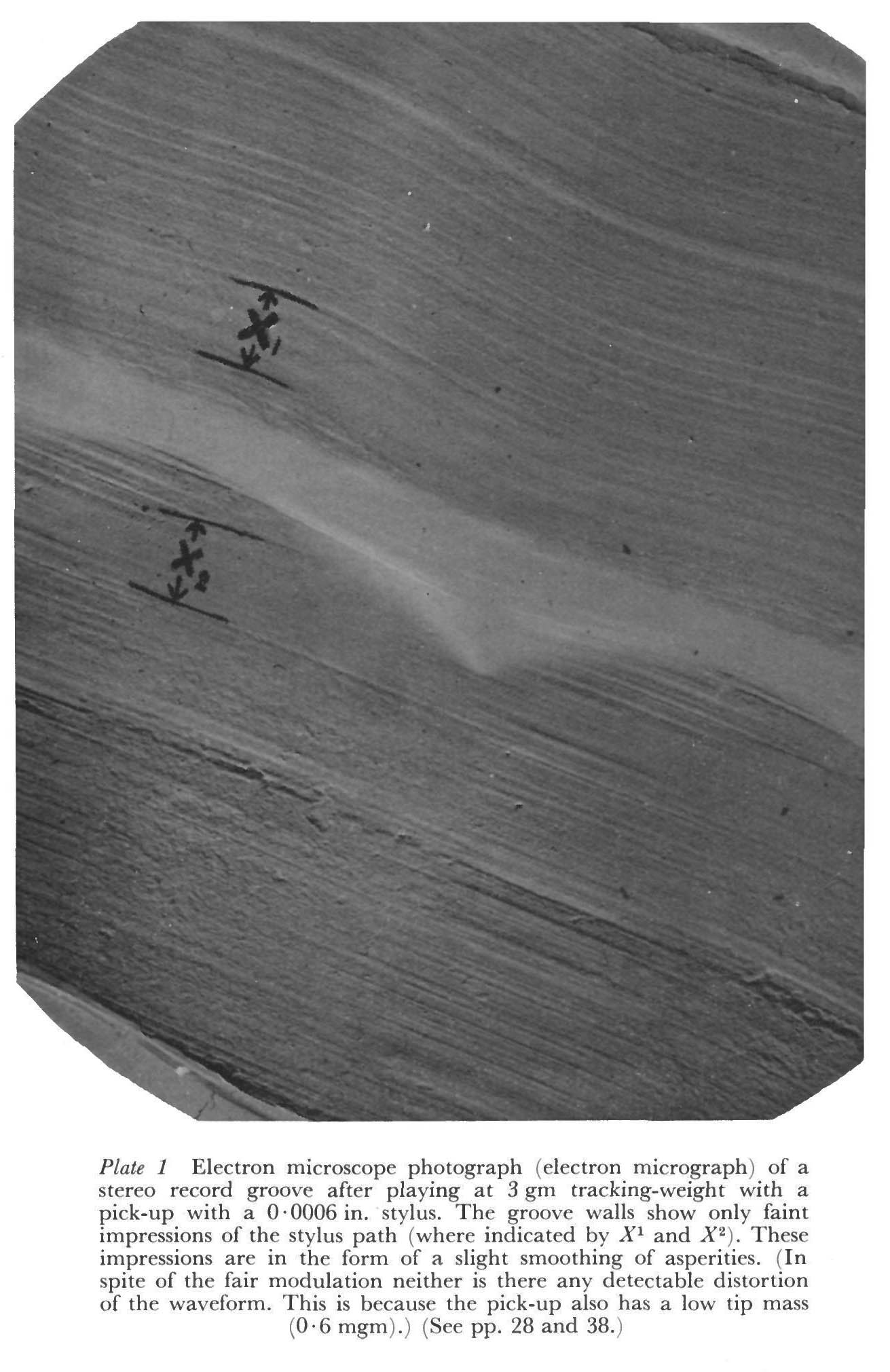

I had/have saved those pictures of groove walls wear for learning purpose. Probably misalignment and improper use affects the playback. If we ignore some well known high fidelity drawbacks; it is a very resilient medium for music.
Regards.

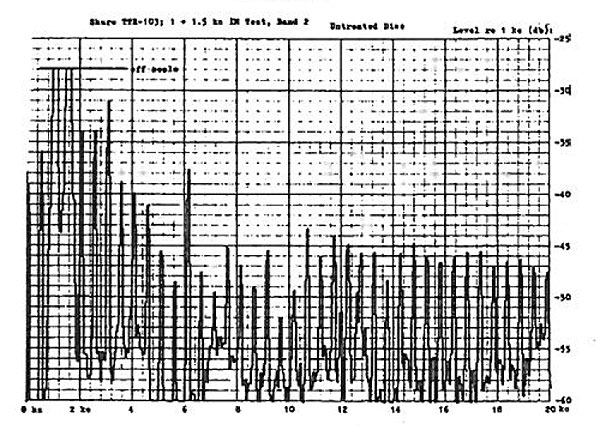

DR Catalano and his patner Walt Davies both worked at LLNL as chemists. Walt was a neighbor 3 houses away. They documented distortion increase due to 'wear' of 50, 100 and 200 plays. Both without and with a virgin record treated with his invention ... called LAST.
THx-RNMarsh
Someone with something to sell invents a problem so he has a solution to it.... Sorry I'll take electron microscope photos over snake oil theories. Oh and like I say George tried to measure wear and couldn't

Hiten showed pictures, I trust those more.

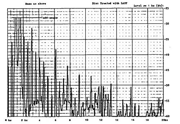

LAST also has done electron microscope studies. i just didnt show them. They exist though and it is for real... before and after distortion and SEM view with and without. Apparently, you are one who cant hear thru the high distortion for the change or just dont "like" the change for the better. Measurably better in any case let alone less wear.
But, I didnt put this up for you or any one person here. Others can do their own homework and learn what is real and what isnt. Studies can be obtained from LAST in Livermore, CA., USA.
But, its your loss, not mine. I hate the high and increasing LP distortion let alone the wear issues of diamond and vinyl.
If there is any saving grace in LP technology, it is potentially wider BW, faster Tr as JC is tuned into.
Same LP copy treated.... Lowered distortion. A nice benefit in addition to longer life.
THx-RNMarsh
