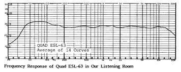

Did you know Richard Lees (RIP) in LA? I measured his QUADs and they were really flat. His nor mine are the 63.. ours are newer design with concentric delay rings.
Even so, the 63 are flatter than Stereophile showed.
Two different internet sourced plots.
View attachment 816534 View attachment 816537
THx-RNMarsh

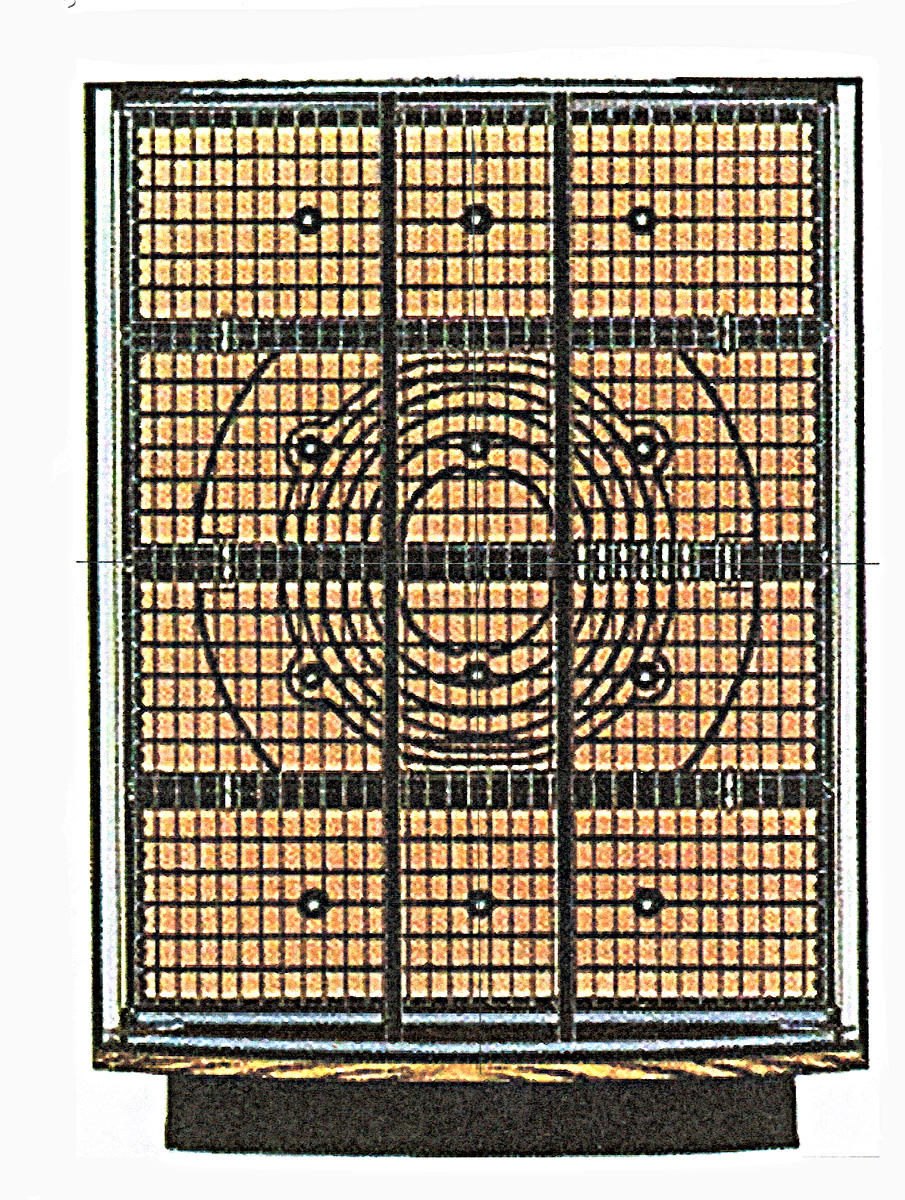

The 63 has concentric rings.
Does it? I have newer 989, I just recalled.

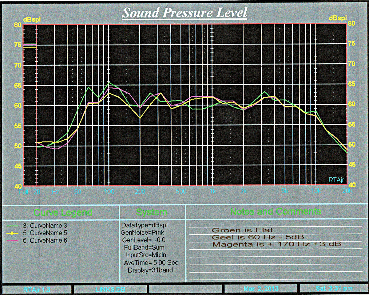

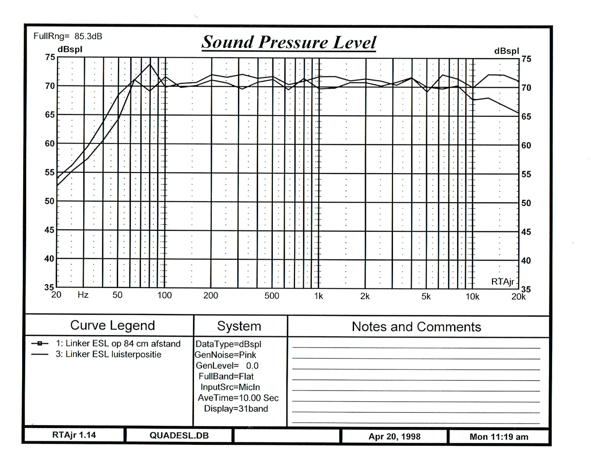

Quad has currently two models, the 2812 exactly as the ESL63 with 4 panels of which the middle ones have their concentric rings, see image below taken from an ESL63.
The 2912 has two extra bass panels, 4 instead of 2 for the smaller models.
The difference is that they are now made in China with a modernised look from the outside.
The 989 that you have is the current 2812 and technically still an exact copy of the ESL63.
FR of the ESL depends largely on the acoustics of the room used.
Below two images.
The first shows a FR in my previous house without any correction.
Two recordings, One from 84cm distance and one from my listening position showing a drop of -5dB at 20Khz.
The second the FR in my current workroom.
Green is with no correction, Yellow with -5dB at 60Hz and Magenta with an additional lift of 3dB at 170 Hz.
Despite all, the HF part shows a drop of 12dB at 20Khz as taken fom my listening position, 7dB more than in my previous hobby room.
I don't now how Stereophile's room looks, but it looks like a non optimal one for ESL's.

But, I would not yet assume the QUAD drops like a rock as Stereophile shows... that would sound really dull. Which it doesnt.
Oh, that's probably due to the big membrane and the farfield/nearfield difference. The big membrane do favour the propagation of plane waves which have less ( half) SPL loss when augmenting the distance, in respect to point source sources that make (quasi - we're talking about perfect sources so a well behaving 3 way is the model) spherical propagating waves.
BTW I never heard an electrostatic nor monsters such JBL M2 😛
That's exactly the reason for the concentric rings, individually driven with a certain delay, to let the speaker act as a point source instead of one big flat panel.Oh, that's probably due to the big membrane and the farfield/nearfield difference. The big membrane do favour the propagation of plane waves which have less ( half) SPL loss when augmenting the distance, in respect to point source sources that make (quasi - we're talking about perfect sources so a well behaving 3 way is the model) spherical propagating waves.

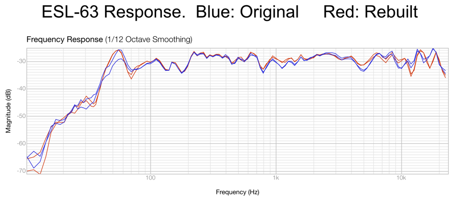

View attachment 816554 View attachment 816555View attachment 816556
Normal speaker measurement is at 1 meter and with a minimum of room influence. Otherwise, every ones far field data will be totally useless for comparisons. But maybe they did measure it in far field of some unknown room characteristics. Big Boo-Boo IMO.
THx-RNMarsh
Hmmm. If it's a ring structure to create a pseudo spherical wavefront, and the bias sheet has significant resistivity requiring a long charging, can the audio signal capacitively modulate the center membrane sufficiently to change the wavefront geometry? Is the center membrane a film with deposited conductance on both sides, so capable of supporting a differential voltage through it's thickness? That would imply a directivity vs DC voltage level caused by lateral gradients in the bias film charge. Again, that would depend on the film electrical time constant and assumes the recent statement of film bias settling time is accurate.What we saw in L.A. was when line voltage was too low, HV was too low and HF response started to drop at some ac line level which i do not know what. Our listening tests of DUT was done with line voltage which produced a flat response to 20KHz.
-RNM
Polar plots vs DC bias would be the tell.
