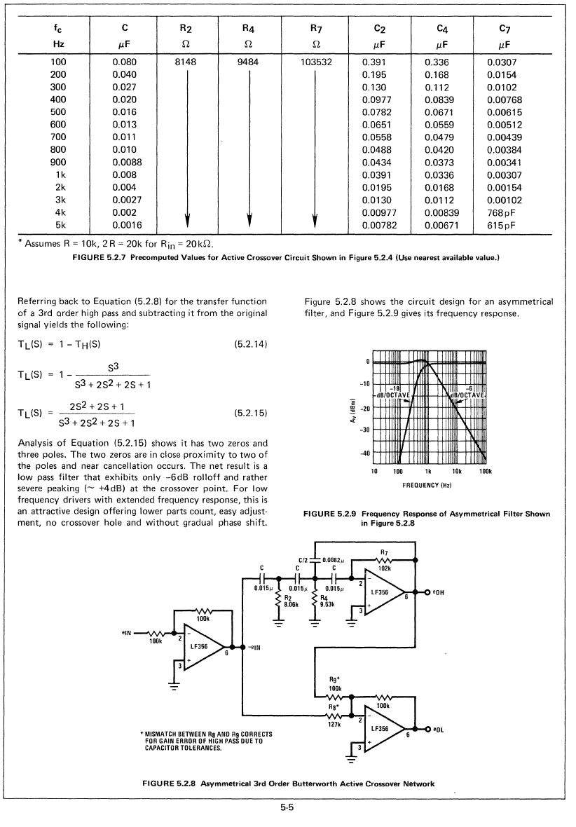

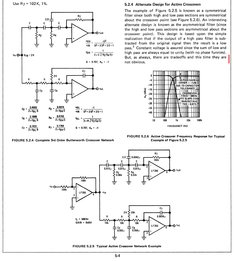

John,
Have you ever paid attention to crossovers where one part has Fr1= H(s) and the complementary part Fr2 = 1- H(s).
In that case you will have a perfect transition no matter how steep H(s) is because [H(s)]+[1 - H(s)] = 1.
Hans
1976, National Audio Handbook
George

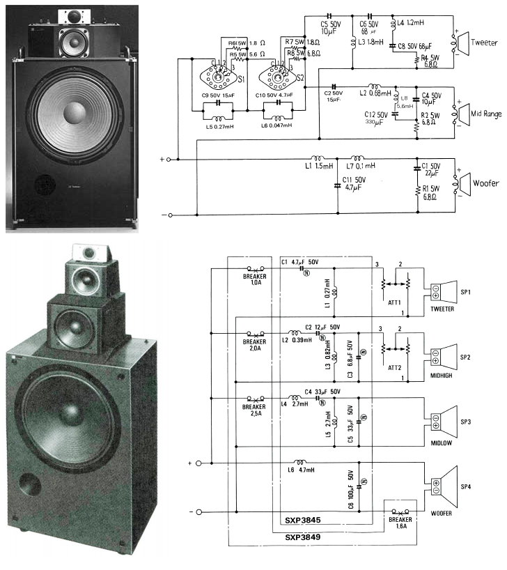

Bang and Olufsen built a speaker line with a "filler driver" between woofer and midrange, fed a very narrow band signal at the crossover frequency. HP and LP filters for the woofer and midrange were 12dB/oct with a Q of 0.5 and all drivers were connected in the same DC polarity. These speakers could reproduce a square wave.
For an active filter, a biquad could be used to generate LP, filler, and HP and the filler could be added to one of the other filter outputs, eliminating the extra driver.
I wish I could remember the names of the guy from B&O and the guy who developed the active filter version, but it's gone.
All good fortune,
Chris
