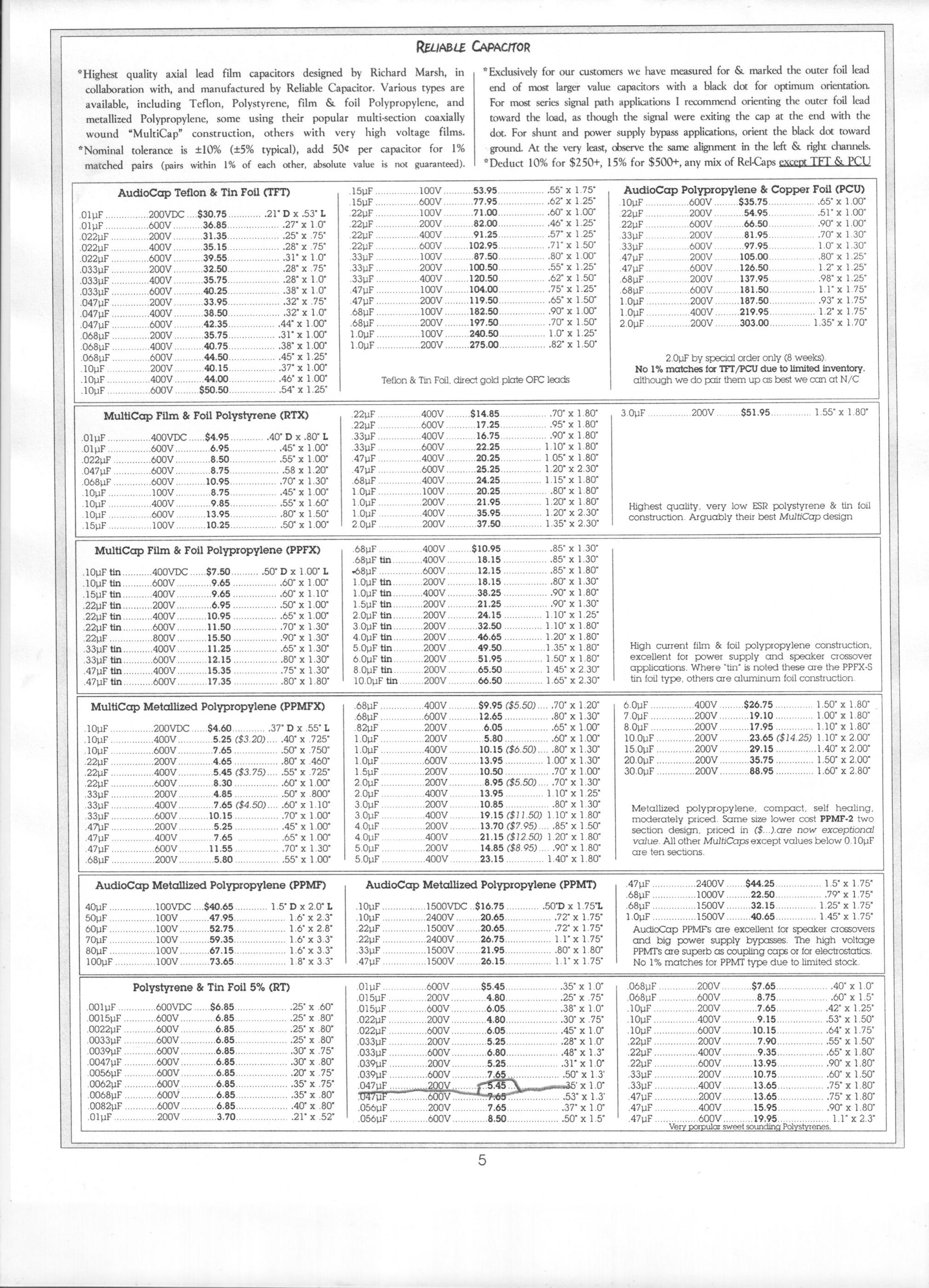

The REL polystyrene caps are almost perfect in construction and performance. I tend to use RT, (which is film, tin foil), but Richard's patented RTX might be even better. (you can measure the difference)
However the cost of these caps is not as bad as Dimitri implied. I am showing the price from the latest catalog from Michael Percy Audio where I recommend that you get your difficult to find, but quality audio parts. Here, the cost of a 0.047uf 200V RT 5% tolerance is ONLY $5.45 ea. Richard's improved RTX cap would cost ONLY $8.75 ea. It is the TEFLON equivalent caps that cost in the $35 dollar area. It is best to avoid them, unless you really want to experiment. Yes, I use them in my personal Vendetta Phono Stage, but then I am not a normal audiophile. They sound pretty darn good, but not that much better.

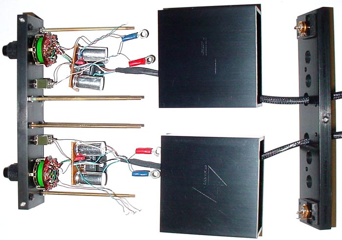

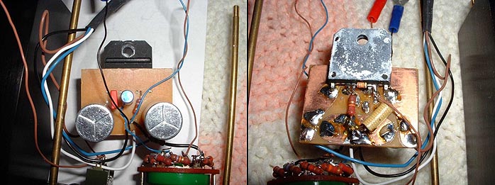

47Labs' secret for getting the best out of chips.
egads, not the well-known short Rf path combined with: 1000uf only ps caps; ps on either side of the chip (=BIG loop area); no EMI on input or output, 12 res series ladder attn on input; DC coupling in/out;
Meh

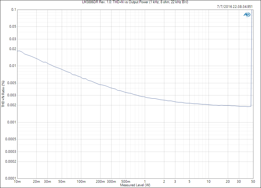

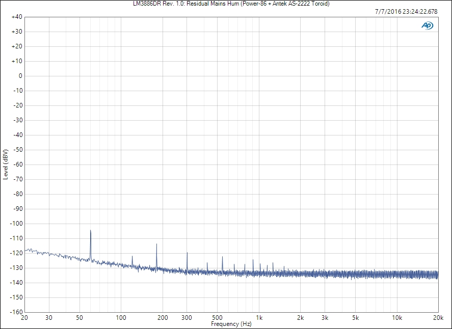

Tom smoked the LM3XXX:
LM3886 Done Right
I did it the same way after that 47Labs said that, soldered the feedback resistor directly on the chip legs. That was a long time ago.
Meh

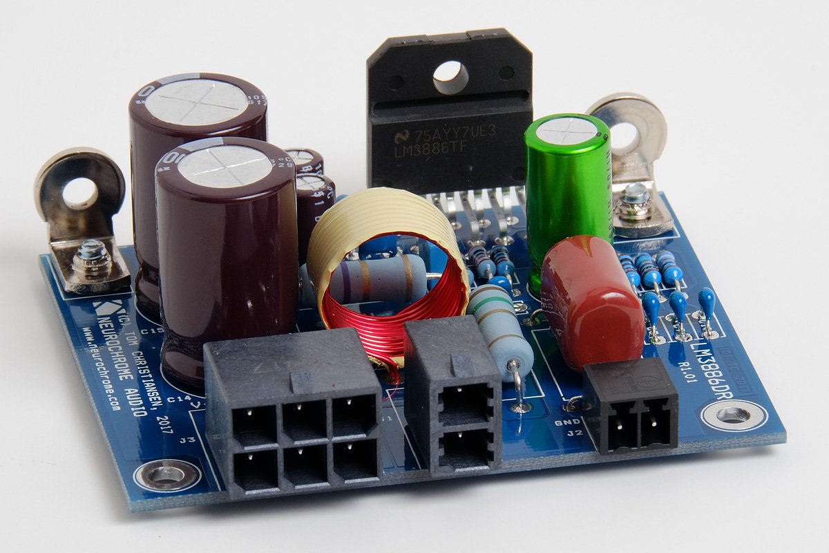

LM3886 Done Right

Yeah, and an output coil on board, close to the input circuitry, that makes me cringe each time I see one. Who cares about magnetic induced second harmonic, it’s not audible, anyway. But careful with the power cords, and don’t forget the silver wiring, those are clearly audible.
Enough said...
P.S. $250/hour for audio design consulting, **** I’m in the wrong business.
Enough said...

Quoting over 10 piece prices for DIY is misleading, I insist on respecting the means of the average person working in their garage/basement.
Mouser has them at this price for just one and in stock. They are under a buck at ten quantity for some. Much better form factor than the Rels also.

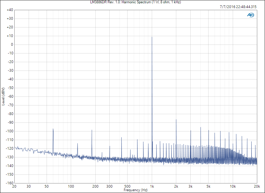

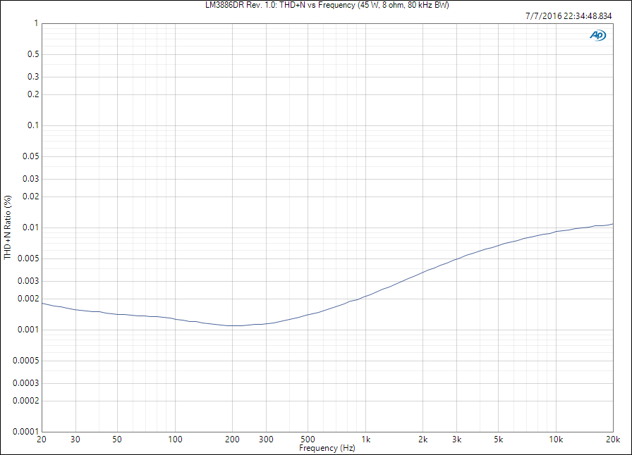

Try again to scare me; THD @1KHz 80kHz BW 1W output power appears to be the same (0.002%, or -94dB) as the THD+N @1KHz 80KHz BW 45W output power. Noise appears to be negligible in your measurements, so that’s not it.
Meantime, it doesn’t pass the smell test, I’m not buying claims significantly better than the data sheet spec.
Design an amp and show it. You've let off enough hot steam to power a river boat.
Waly, Tom's amps are composite amplifiers. The newest iteration uses OPA1611 with the LM3886 in the feedback loop.
