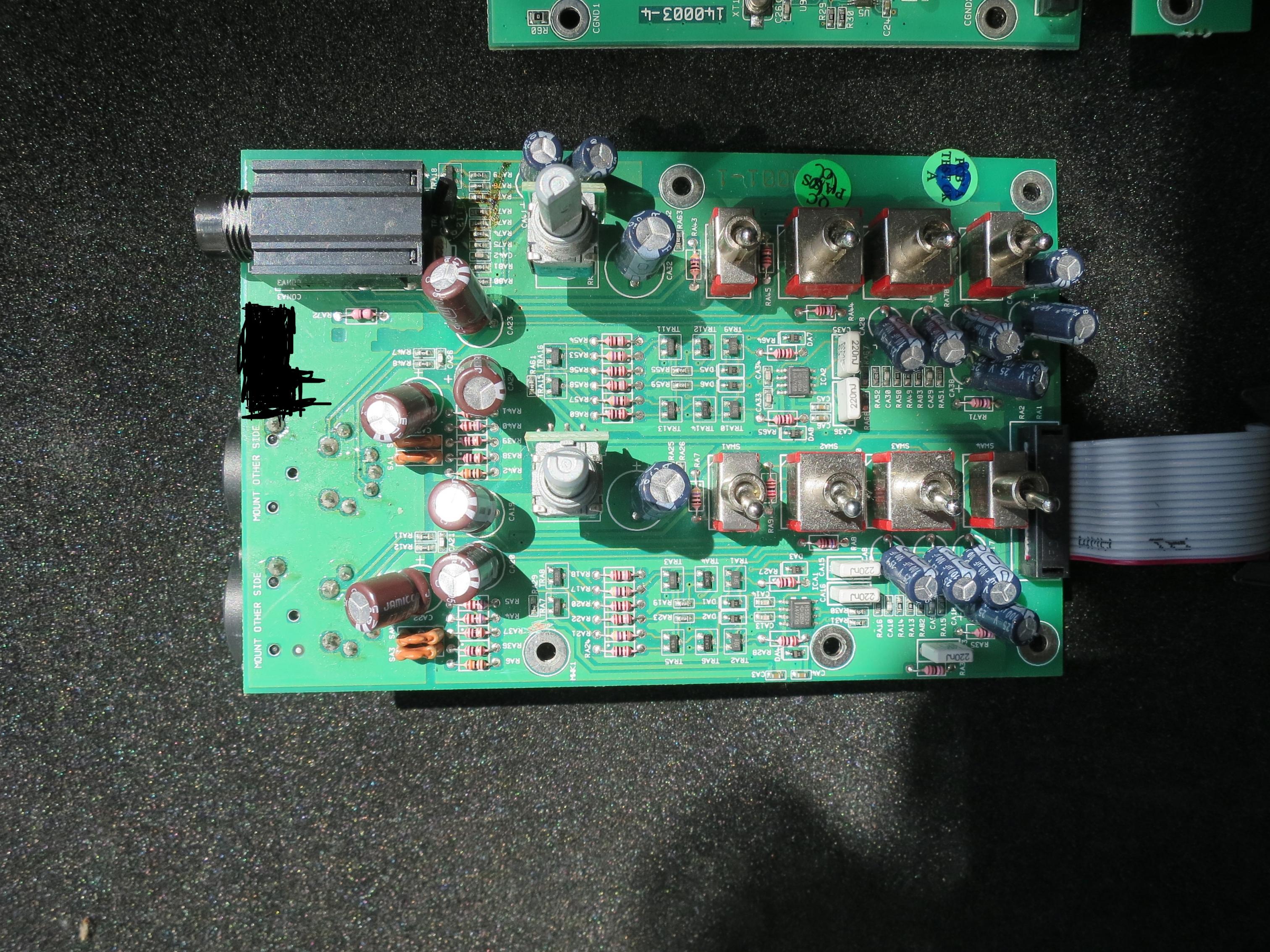

I only bought this for study...this would be a modern mic preamp in a very well sold kinda cheap professional recording sound card(production -2016)... transistor input(bipolar) preamp with soft saturation to prevent the adc input clipping as the manufacturer said on his official page, ne5532 at the output...Looking at countless reviews, giving it for review to my friends who also have 2 small recording studios for more than a decade now...they all seem to be very happy with the sound...and Amazon's sales tells a lot about the perceived quality of this thing. I don't know what you say, but i've seen a few posts about the fact that TI improved the ne5534 die and that new ne5534 is better than the original. All the statements i see here about ne5534 are based on the original ne5534. If you think that they were better than the new ones...I might have a few good original Signetics AN, dip and smd 🙂

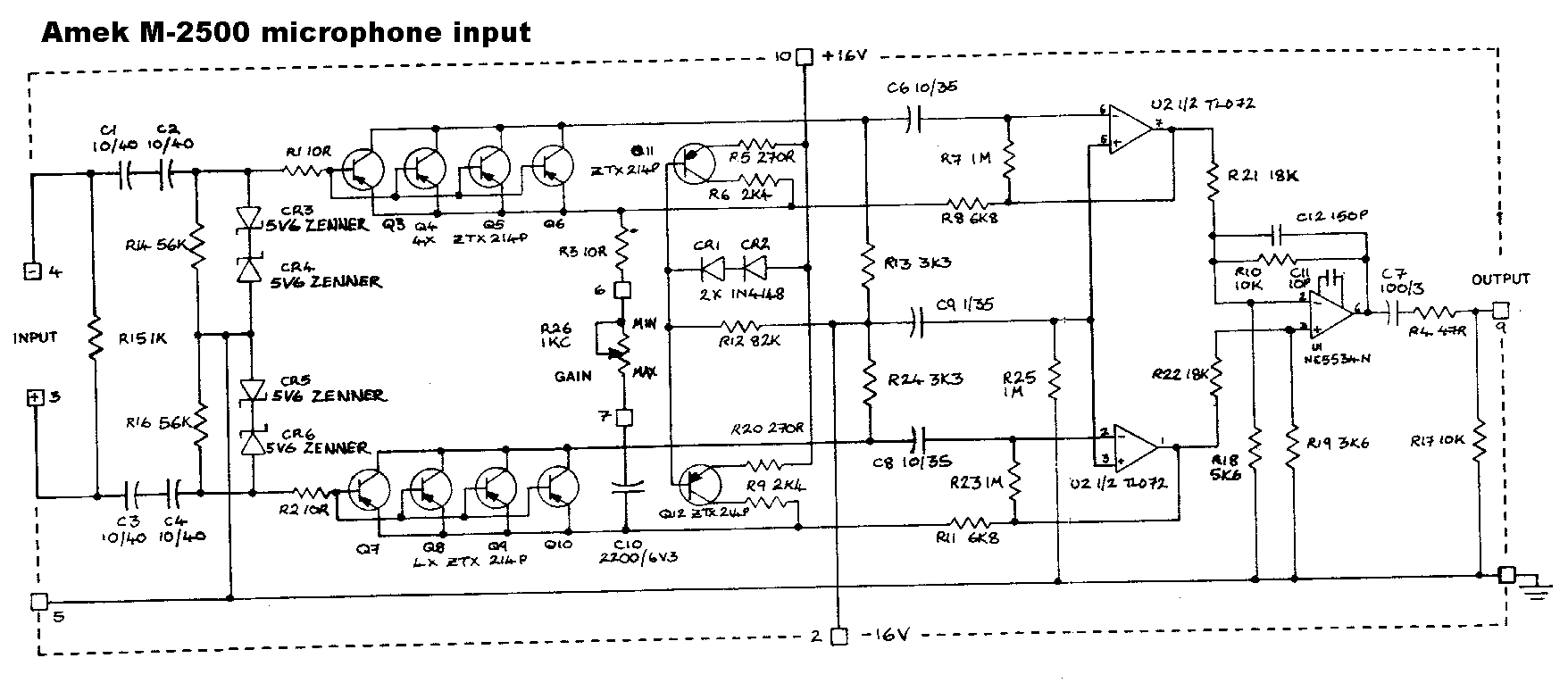

About caps: They are everywhere, in all the desks I know, to avoid any noise of commutation.
About VCA. Oh lord, what awfull sounding they had (Automated process & such). Reason why Rupert Neve invented the expensive and complicated flying faders to get rid of them.
About Neve, most of the ones I saw inside (So, expensive, never had one on my own) were based on discrete components, if I remember well.
Attached, a typical mic input of an average studio mixing desk, and some schematics from NEVE.

I know the Amek for a decade or so.Good design.It also have a great eq, i heard.but the cheaper Mackie vlz1604 and Soundcraft spirit folio did a better job with lower parts count.
