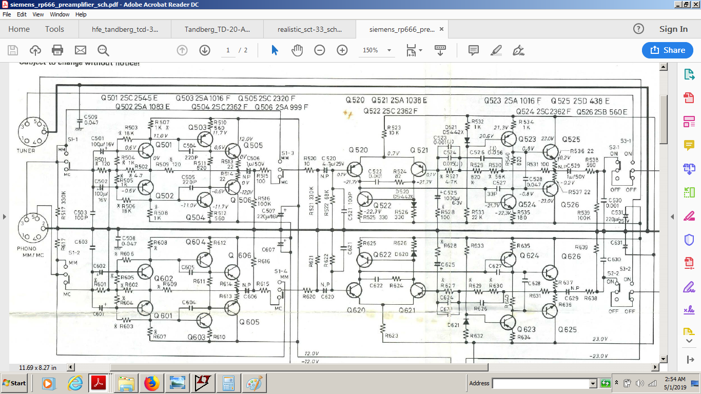

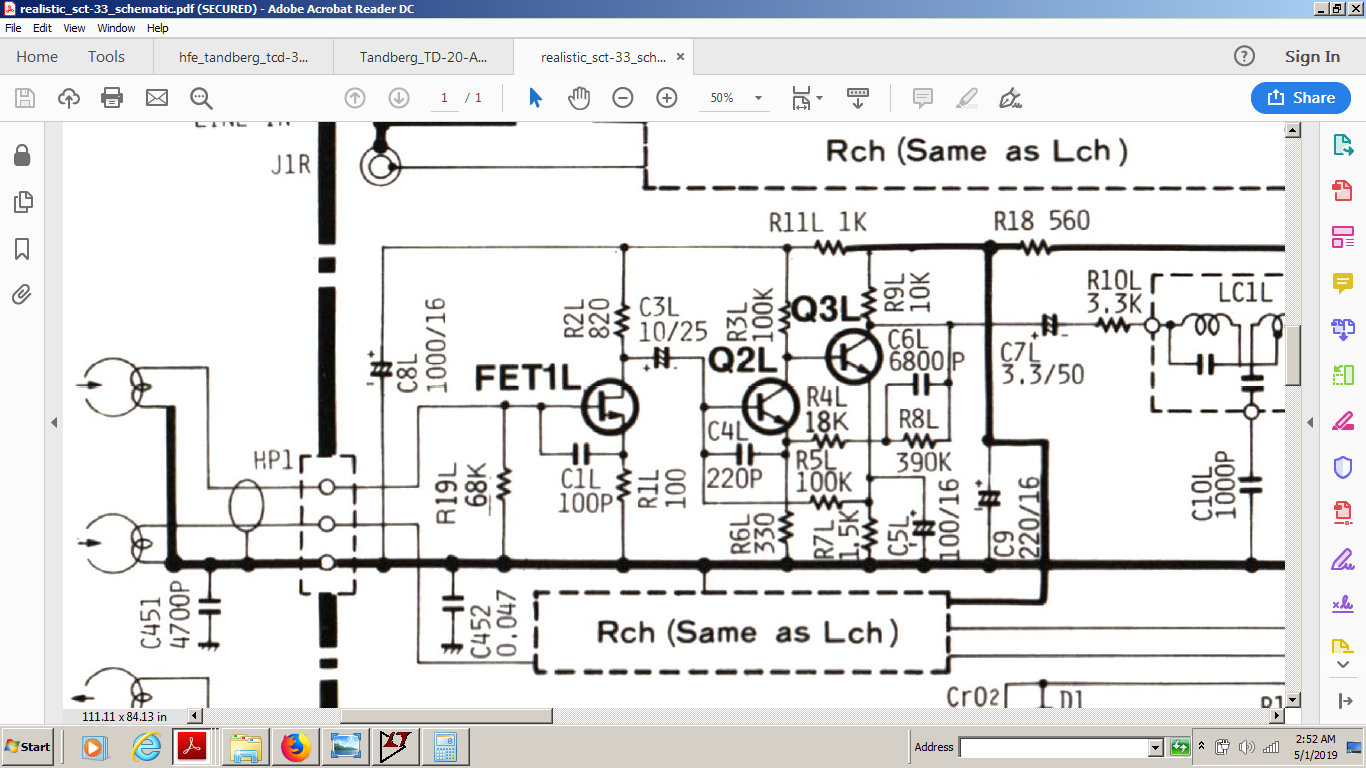

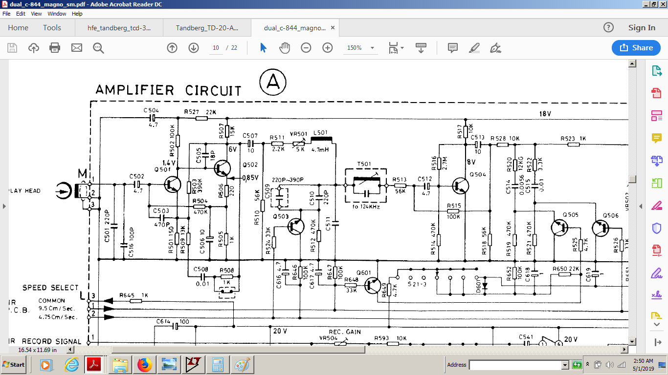

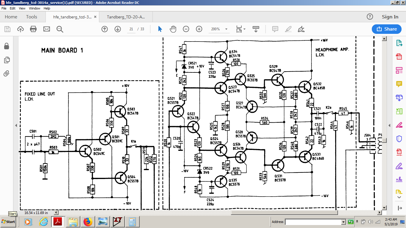

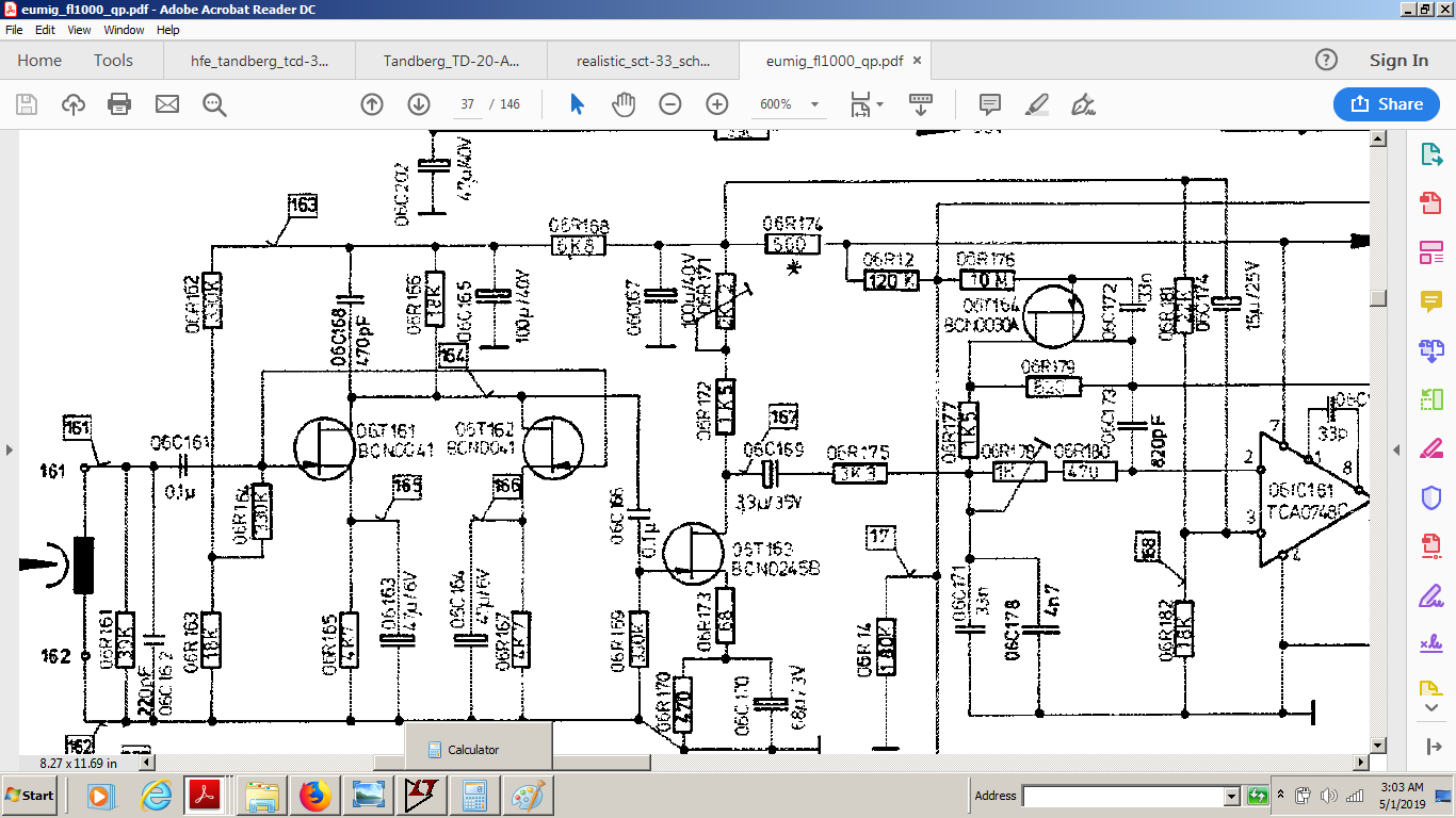

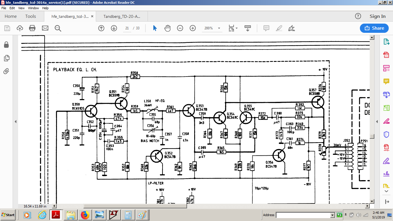

Just some other cap coupled stages of yesterday...I wondered what geniuses must have been the Tandberg guys to keep all their sh..t together in that schematic and give a masterpiece of tape recording with no fet transistor and no global feedback , but look at their headphones amp section!
That is the next amp i'm going to build!
It fully got my attention.

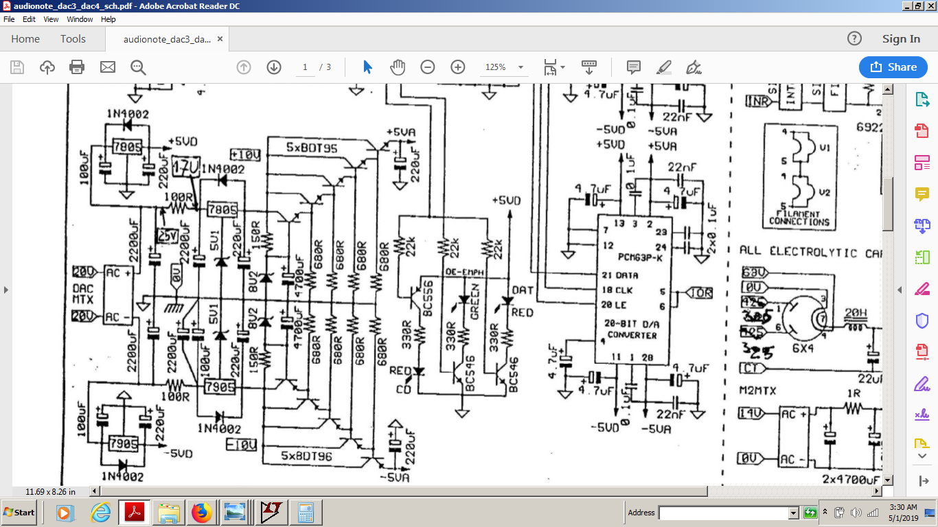

The best regulator is no regulator...but let's just see what Audio note did with the 7805 maybe we get something out of it:Sure, the 7815 is not bad, but it's not very good either. Good regulators have lower output impedance over a much wider frequency range. I believe that even with circuits with good PSRR a superior regulator makes an audible difference. Of course, I have absolutely no evidence to back that up. 🙂
.. let's just see what Audio note did with the 78l05 maybe we get something out of it:
Good use of CRC on the input side. The utility of the output side though escapes me....

I took myself the time to build a loaded capacitance multiplier this way and i was please with the results, but indeed , 78lxx series is very good .I use them extensively everywhere and load it accordingly...Most people load it minimally but they need more than 5...10ma load to work best and besides that i always put enough low esr capacitance at the output.Good use of CRC on the input side. The utility of the output side though escapes me....
