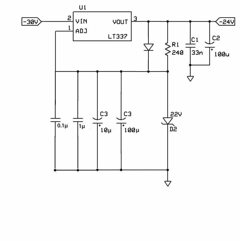

Patrick, picture (e) is the best, Zener is filtered, 22V Vbe multiplier is not simple.
Chis, ML No5xx and No5xxx have LM317/337 with BJT filters, only No523/6 has discrete regulator

May-I suggest this (diode added to discharge caps):Here are my measurements (keep impedance of adj pin circuit low)
Thanks Dimitri.(B) has huge noise below RC, use large cap then
(B) has worse dc stability
Between (B) and (D), which one would you choose and why?
George, your choice
trade reduced dc loop gain (b) for random (within the limits) zener voltage (d)
(b) has higher lf noise
LM337 requires large Al cap on the output, LM317 doesn't
