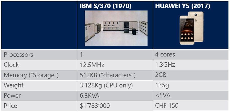

Time flies... I wonder how useful are the "ancients" today? Attached is from my course material illustrating what half a century brings. Fast forward to the 80's, and I remember struggling with a thing called Turbo Pascal on a PC AT: no good for math because of a hopeless floating point library.
