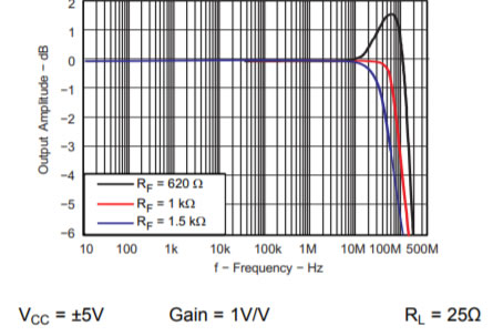

Argumentative ?Mostly true, but there are many high speed amplifiers used in audio products today which 100 MHz BW would not cover. If you use a TPA6120 or other CFA, for just one example.
I design current feedback amplifiers since 4 decades and said 300MHz in my first post, but, really, I think 100 is large enough to work and ensure no instability IMHO.
Most of the old geezer of my kind started their career with 10MHz and we did the Job.
Fortunately, the analog oscillos did not have a brick wall filter!
