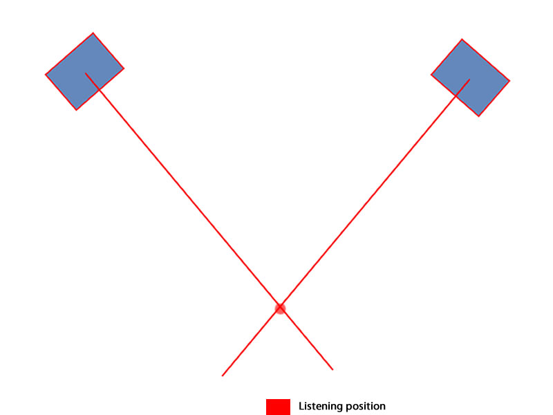

I usually set a equilateral triangle with speakers and listening position as the angles. But i cross the speakers in such a way that their axes crosses closer than the listening position. around 2/3 1/3 in front of the listening position.
It enlarge the lateral listening position, flatten a little the extreme trebles, erasing some unnatural excess (hifi effect) and produce a more natural restitution without loosing impacts on cymbals, as an example. Just try to orient them this way for the best result. I will be curious of your feedback.
