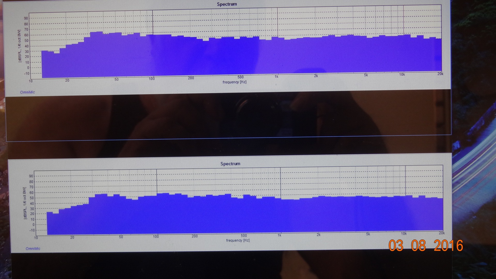

OK well I did find this --->
I found this one of the JBL M2..... raw spkr/room data measured at the listening seat. L and R speakers. No EQ applied. No roll off at high end.
I measured it at my listening location in my home. It was unusually flat 40Hz to 20KHz.
Looks like +-10dB to me,

As it is usually good to have a response curve slowly descending from bass to treble, i would say +- 5dB or less. That is remarquable, on my point of view, in a listening room out of free field or anechoic chamber and close miking.Looks like +-10dB to me,
Don't you agree ?
[edit] I noticed that the global curve follows more or less one of the the Fletcher and Munsnon curve. That will give a better balance at less level than 100dB. Good thing too.

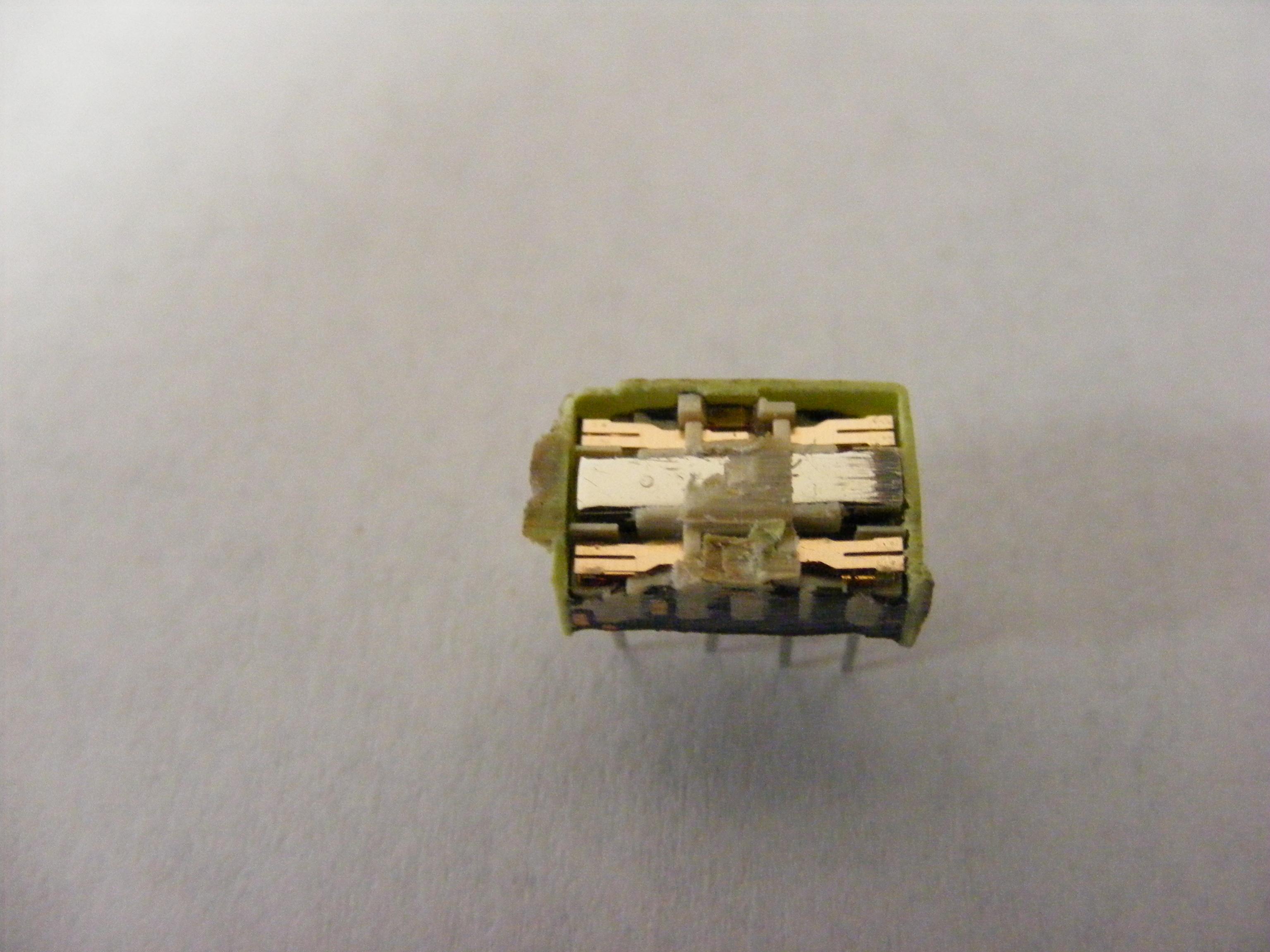

First picture is of a typical small relay. It has silver plated copper contacts. The idea is that if you use it for small signals the silver will give good low level performance. When used for larger signals and currents the silver plating will burn off and the copper contacts will handle higher current. So a used relay probably is not a good idea to re-purpose it for audio.
Second issue is to note the moving contact is attached to the steel magnetic armature. This will introduce distortion by passing your pristine audio signal coupled with the magnetic hysteresis distortion of the supporting armature.

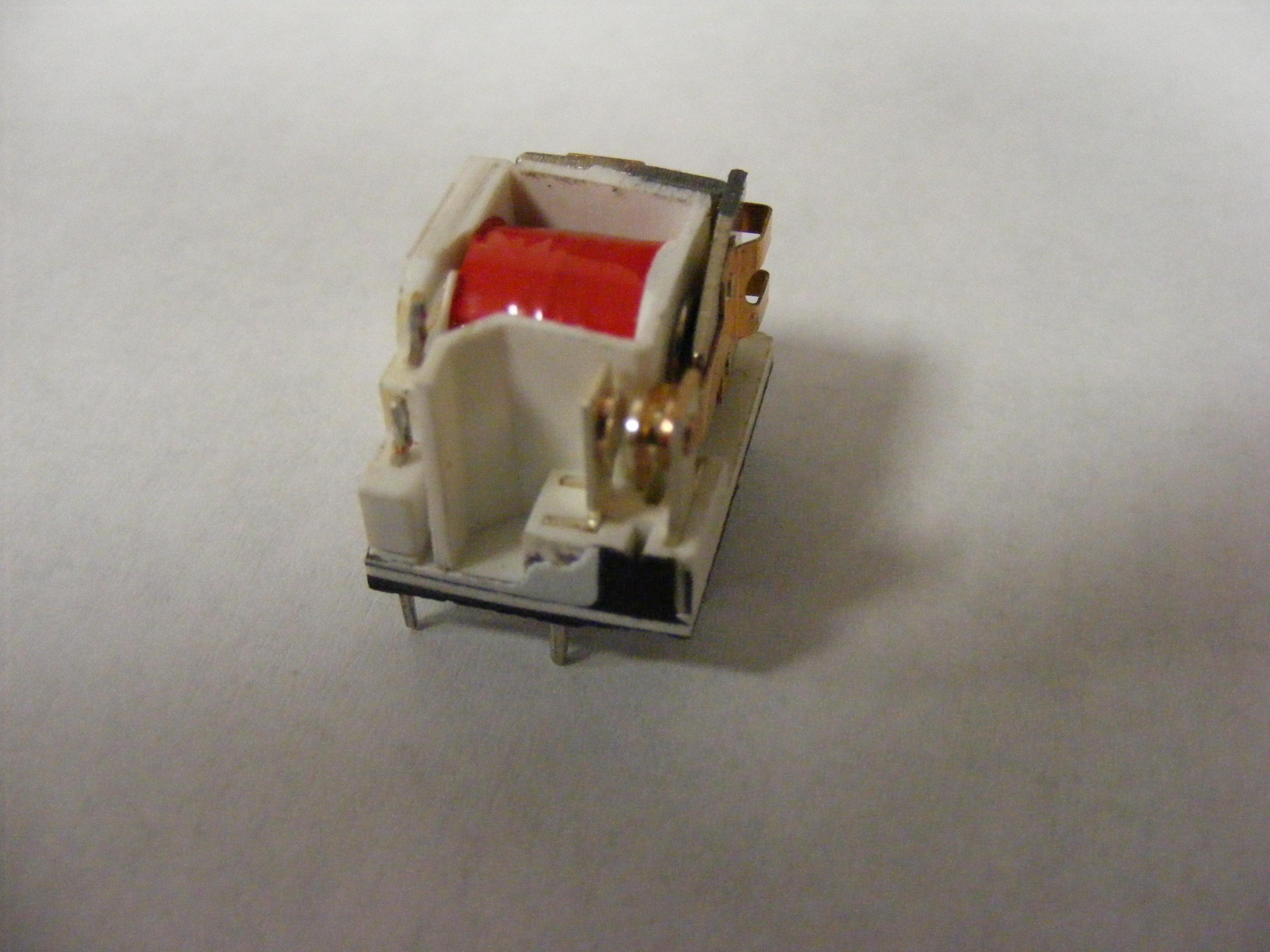

The second relay if you look closely has bifurcated crossbar contacts that are silver or gold plated. More importantly the moving armature is off to the side and there is no parallel signal and magnetic path. (AGQ26012) This is a relay that is designed for low level signals and will fail if used for switching more than two amperes! It is rated to switch 10 uA or 10mV.
FYI!
FYI!

The speaker article that was under discussion at the time, comparing LS50s etc...
Thanks for finding the measurements!
