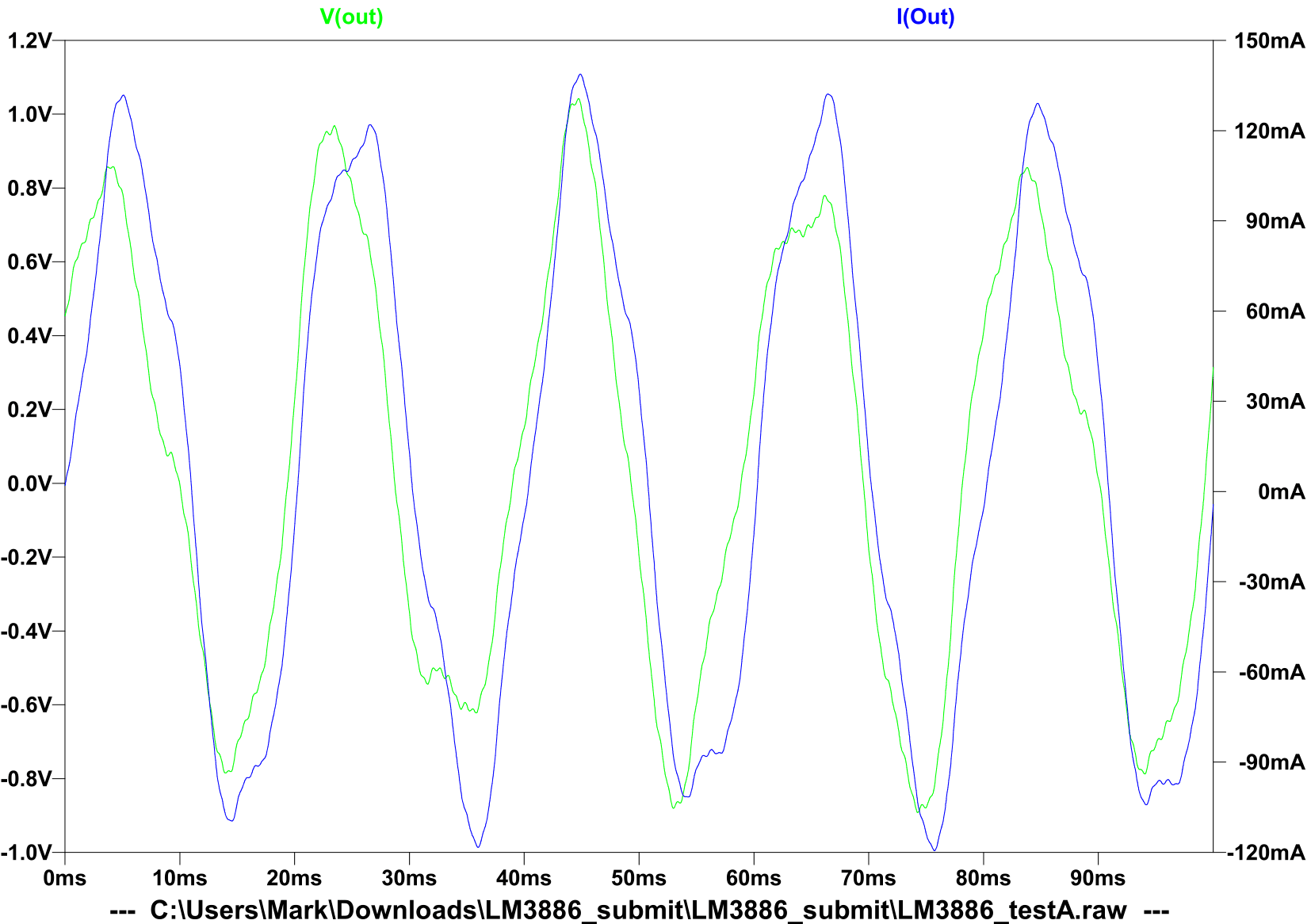

Looking at the the posts Indra referred to, It seem we can take for granted that driving the moving coil assembly with a current source produce less distortion. Both harmonic and intermodulation. While PMA has not indicated all the conditions of his mesures. (For example, it is clear that the acoustic levels has been equalized between the two mesures of distortions ?)I must admit, I missed that offer. Thank you for your thank you.

Tounesol, I believe what Joe is referring to with "no reactive current" is that with current drive, the current has no phase shift relative to the input signal. You could call it a reactive voltage.
With voltage drive, the output current and the input signal look very different when using a multitone signal.
Depending on the type of drive used, the input signal resembles the output voltage or current. See below.
