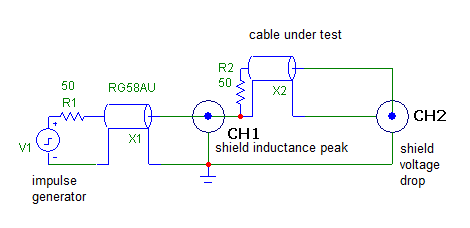

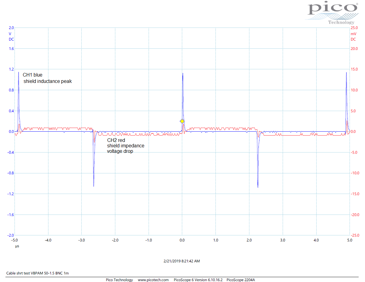

Regarding link level unbalanced cables, shield impedance (together with impedance added by connections in terminating connectors) is IMO the most important parameter. It should be as low as possible, both inductance and resistance, to add minimum interference voltage to an audio signal.
I have a special test for this, as attached. Impulse/square generator is coupled by impedance matched cable to oscilloscope CH1 (blue trace). Then the cable under test is driven to its shield and shield voltage drop is measured by its center conductor to CH2 (red trace). CH1 shows inductive voltage drop across shield of the cable under test and CH2 shows resistance+inductance drop on the cable under test. This is quite sensitive method which is able to tell huge measurable differences between "audio" link cables. Of course, the best is good coaxial cable with the lowest shield impedance, as expected.

Nice test 🙂
Ed, surely in your test setup you could have two cables side by side. One is the ref cable so you never turn it around, and the other is the one you flip to do the cable directionality. Subtract the differences between the two. That way - to a 1 st order approximation - you remove many of the test confounders.
If you are seeing directionality, maybe it’s because of easily explainable EM theory. For example, the cable lumped impedance may not be uniform end to end, so when you flip it, the instruments see slightly different termination impedances. Just s thought.
Fast rise time spikes would help show this up readily like PMA’s test.
