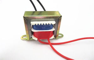

That is where you change the hot side of the primary winding from outer to inner, makes a difference to the coupled in mains hum, possibly to the amount of RF sneaking in too.
Good suggestions, but....
Radios and Radio-Cassettes of the day all ran Double Insulated compartmented transformers like in the pic, so presumably Pr>Sec capacitive coupling is minimal and being a floating AC load there should be no real difference in coupling of line noise to circuitry according to supply polarity ?.

Another thing I noticed as a kid is that the polarity (orientation) of the standard reversible Fig 8 AC power cable makes a further difference.
I have tested this over time with a large range of 'portables' and same result.
Perhaps somebody has theories as to why this is ?.
Not complicated. You are connecting together two or more AC powered devices.
Depending on the way each one is connected in the AC, you will have a relative difference in their AC "leakages" to the ground. A voltage that you can measure between their grounds before to connect them together. This leakage voltage (high impedance) will generate a parasitic current across the grounds of each device, once connected.
The first thing I do when I connect each device in a system is to measure this voltage , starting with my pre-amplifier alone, choosing the best phase for the amplifier, and doing the same for each device i add after this.
Of course, it is less critical if you use true symmetrical floating signal connections everywhere.
I used during years a little headphone amplifier that I carried from studios to studios. It was both AC powered and batteries (4X9V). The difference in clarity was obvious. Both between batteries, best AC phase, worse AC phase.

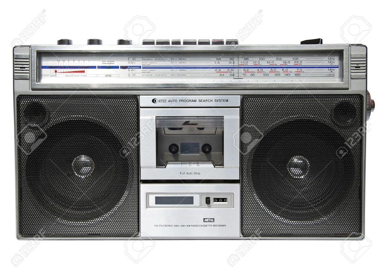

Thanks Tourney, I well understand transformer leakage currents and transformer primary phasing/polarity to minimise chassis/earth capacitive leakage currents.
I am talking about standalone plastic case fully insulated radios and radio-cassette players like the pic and mono versions of the day.
Dan.
Anybody have any ideas on why the sound differences ?.
Dan.
Wrinkle has it right. Where the hot lead is wound closest to the core more noise couples to the core, ground and secondary. There is more leakage capacitance from the core to secondary in addition to primary secondary measurement by itself.
I showed measurements of this a while back.
