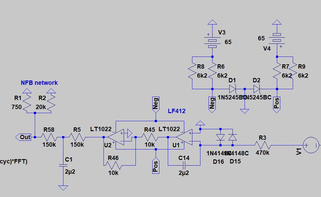

Am I old fashioned with my LF412 servo?
The servo in picture below is keeping my amp below 1mv DC offset, measured with fluke 8808.
This one has -60dB gain at 10Hz, it takes about 1 minute after powering up to lower DC offset from 0.4v to 0.
Would a better performing opamp make a significant change in noise?

The way to view this servo thing is that in a decent amp with feedback, the output offset and drift are 2nd or 3rd order effects i.e. the main amplifier loop for the most part has the offset under control to within a few tens of mV. You therefore only need a little bit of assistance from the servo to bring the offset under control.
You can see this in practice if you dial the amplifier offset out manually so that the servo controller output is exactly 0. The servo output remains at or close to 0 (within a few mV) right down to a few Hz (and over temp - a good LTP or CFA DB stage is quite DC stable over temp in a practical audio amp). Its only when you get to 1-2 Hz and large rail excursions that you see any appreciable change in the servo output. A lot implementations actually attenuate the servo output substantially by using a series resistor feeding into the servo summing node on the amplifier - so they really are quite 'hands off' wrt to the main loop above a few Hz.
Separately, if you are hearing a big sonic difference with a servo, you have other issues. either its a sub-optimal servo design, or the amplifier is suboptimal and the servo happens to be improving it . . . 😀

Servos aren't toys, and IF they can be safely eliminated, so much the better. BUT if you do, you are liable to 'throw the baby out with the bathwater' and you will pay more, and get less. It is relatively easy to make a lousy servo. You can make the bandwidth too high so that it dances along with the music. Not good. Or you can make it from 'junkbox' parts and add some sort of nonlinearity to the gain stage. Or you can feedback to an input position that creates some measurable offset, because you are too lazy to make the amp, etc, virtually DC accurate in the first place and too much error correction causes added input stage distortion. That is why the Blowtorch has second stage servo correction. The first stage 4Q jfets are fully floating, so they are not much effected. And finially, NOISE or INSTABILITY from the servo ckt. This is a real engineering set of tradeoffs, amateurs could make a mistake and then for evermore tell everyone how servos don't work. '-)
