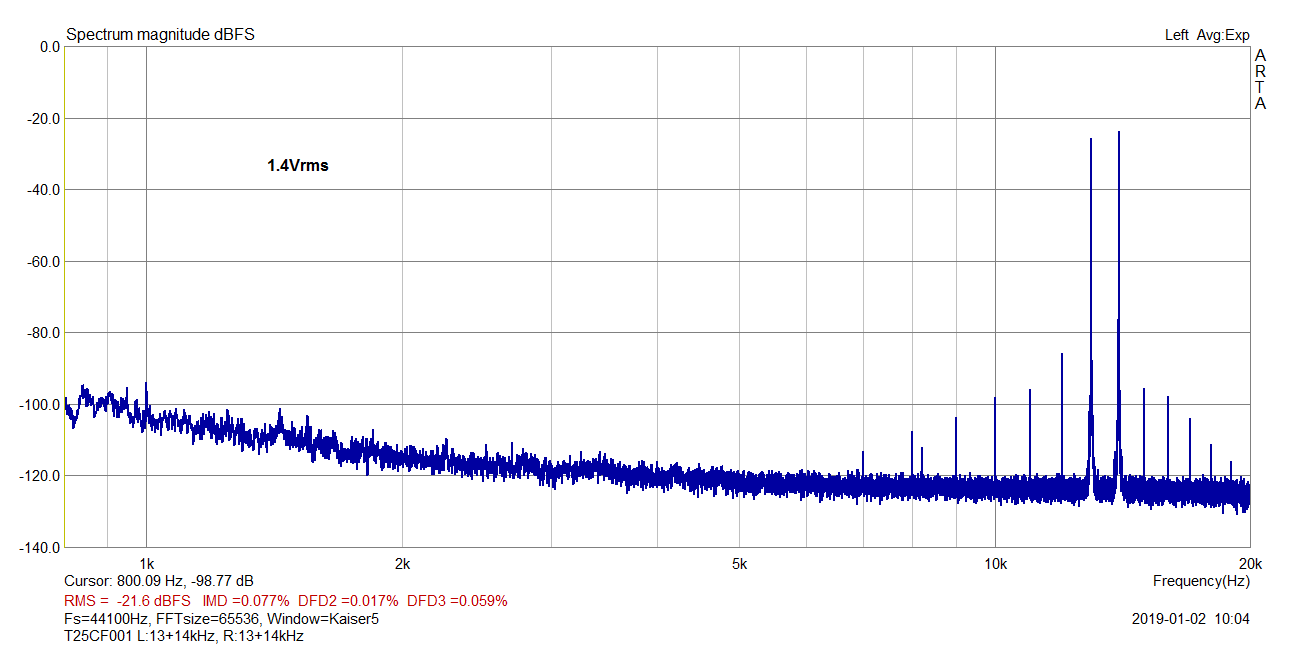

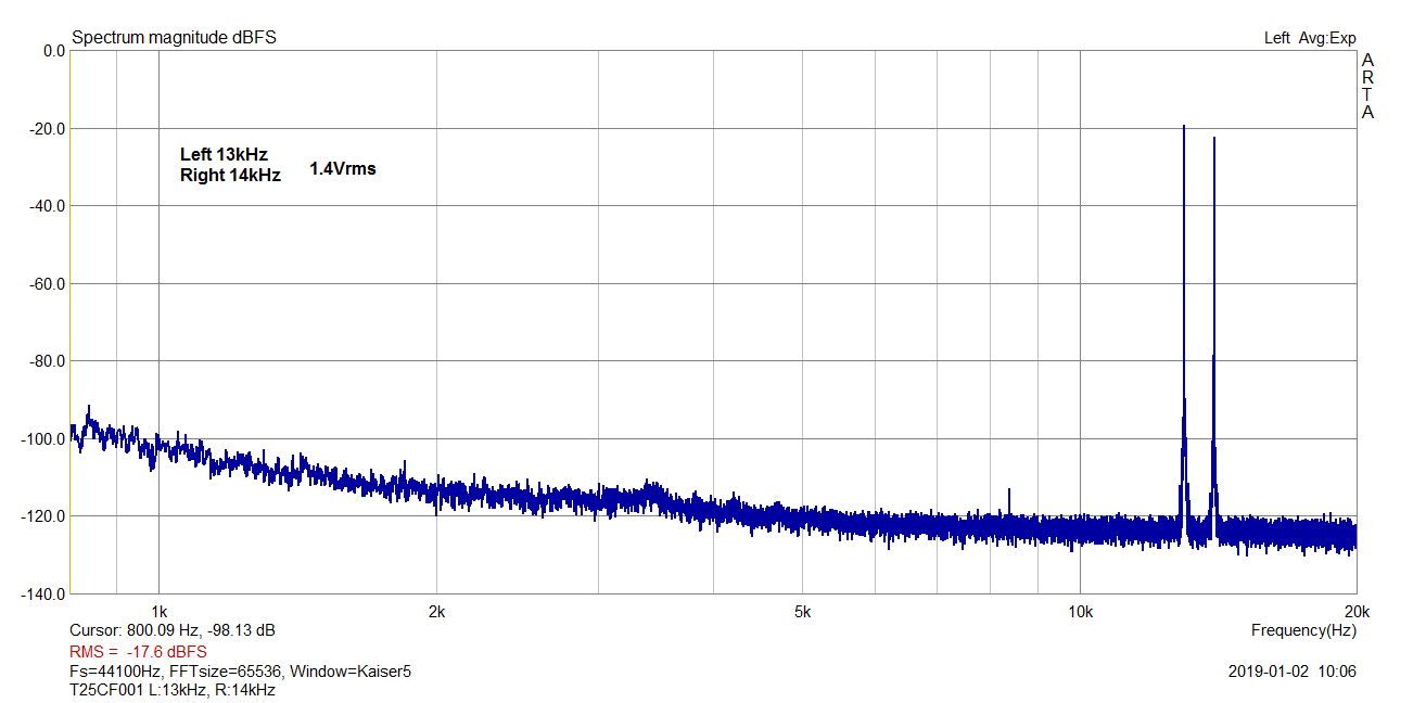

I have decided to try a big 1" condenser microphone for the 13+14kHz tweeter test and it seems to be the right choice. The 1kHz difference tone has gone and 2 driver test is clean now. And, dynamic range is higher - lower noise.

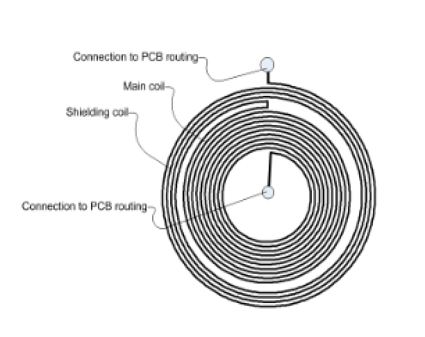

Also I read somewhere that one manufacturer attempted to use shorted turns on the ends of the voicecoil to limit excursion, but that it caused alarming sounds on overload? Can anyone fill in the details on that story?
What you suggest will work only due to eddy currents action but I guess the effect will be weak except at high frequencies and high velocities.
Now, see the attachment for another idea. In the original application (eddy current search probe), it is a coil, the outer ends of which is wound in the opposite direction. This is to achieve some magnetic field guarding or shielding without using ferrite or mu metal around the coil.
In the case of voice coil, such kind of counter winding (now at both ends) will exert a Lorenz force counter to the one that the main body of the coil exerts when these coil-ends reach the magnetic gap.

Great, but unfortunately adding another coil to a tweeter will seriously alter it's characteristics that may render the dvc method unsuitable for most tweeters.... for the 13+14kHz tweeter test and it seems to be the right choice. The 1kHz difference tone has gone and 2 driver test is clean now. ...
Even if it's using wire 1/5th the diameter nested in the valleys of the voicecoil? It seems to me there is room to work there.
Pretty quiet lab? This is as expected, the mic is far better than the speaker.
Thank you, yes, though I live in a capital city, fortunately it is a very quiet place and windows have very good acoustic isolation.
Measurements with a high S/N microphone reveals the interesting point - I think that my speakers are a non-issue re nonlinear distortion everywhere but close to and under woofer resonance. The most audible would be IMO the cabinet noises or driver mechanical noises that are non-harmonic. So, there is a question, if it makes much sense to concentrate on driver non-linear distortion in case we use some decent drivers and if the efforts should not be spent to minimize cabinet contribution, just like DW did, and to improve drivers itself re mechanical design, which would lead to very expensive parts, IMO, but might be the right way.
