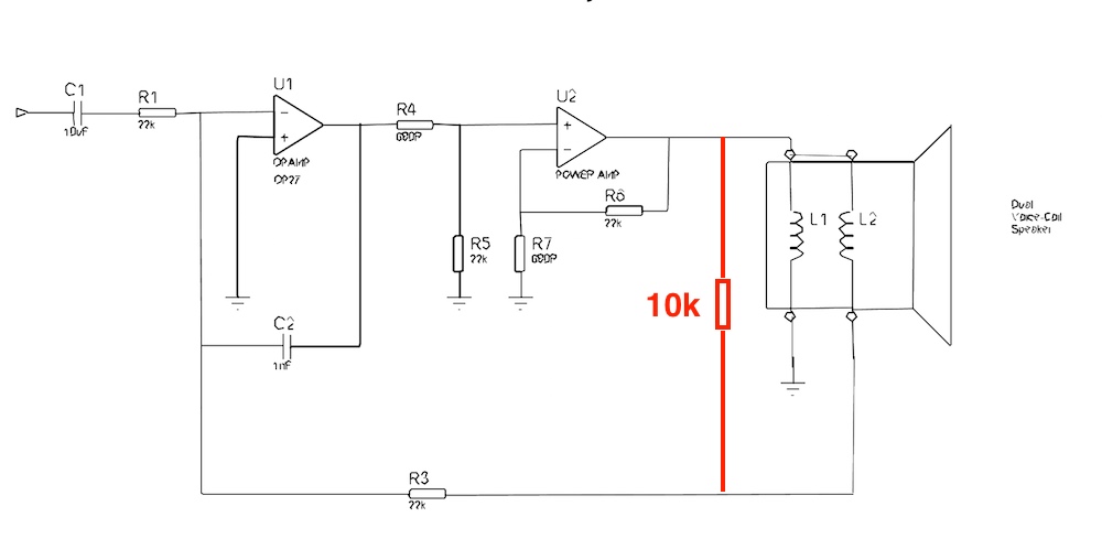

...in theory, this scheme will control the vc throughout it's working range. My prediction is that it will flatten the acoustic output response, flatten the phase, and lower distortion.. But it'd be nice to have that confirmed or shot down in flames...
In practice it has limits, and does require equalization, since it moves the
piston drive off of the "constant acceleration" paradigm, and there is
the non-trivial communication between the two voice coils.
But it's quite simple to implement, and does work pretty well for subwoofers.
Are you talking about the scheme I spoke of? Or are you talking about current drive? There's a schematic about a bazillion posts back (two days ago) that is the closest.
My scheme absolutely requires the communication between the voice coils. It depends on both coils coupling exactly the same to all the flux. It's purpose is to use the real part of the impedance of the speaker as the feedback node. That way, the amp will drive the reactance, but the fidelity will be between the input signal and the real component of the speaker response. at the driver.
edit:here is the post, I can't figure out how to copy the picture.. but I would break into the amp and use it's normal feedback.
This scheme absolutely requires a bifilar or co-wound voice coils, as it also rejects variation of vc inductance vs position, if the coils are front/back, that cannot occur.

Like this?

Does underhung vs overhung voicecoils affect it if it does?
I would love to test the concept, if I can get a break from headphone work. Basic.tests would not be too challenging. Two or three days effort to strap everything together and get real measurements if a stock dual voicecoil driver will work.

So it has been done like this?
It should not affect it. Any magnetic non linearities will be seen by both coils identically in the case of co-wound or bifilar or my interstitial scheme.Does underhung vs overhung voicecoils affect it if it does?
If the coils are front/back, excursion based inductance non linearities will be worse.
Nice. I was thinking that the values might be driver dependent. As in, if the second coil opens, the resistor may have to be altered such that the acoustic power remains the same, just that the non linearities would not be compensated out. It would be nice if output stayed the relative same level for pro apps, but it might be good to have a level change indicating a break.So it has been done like this?
