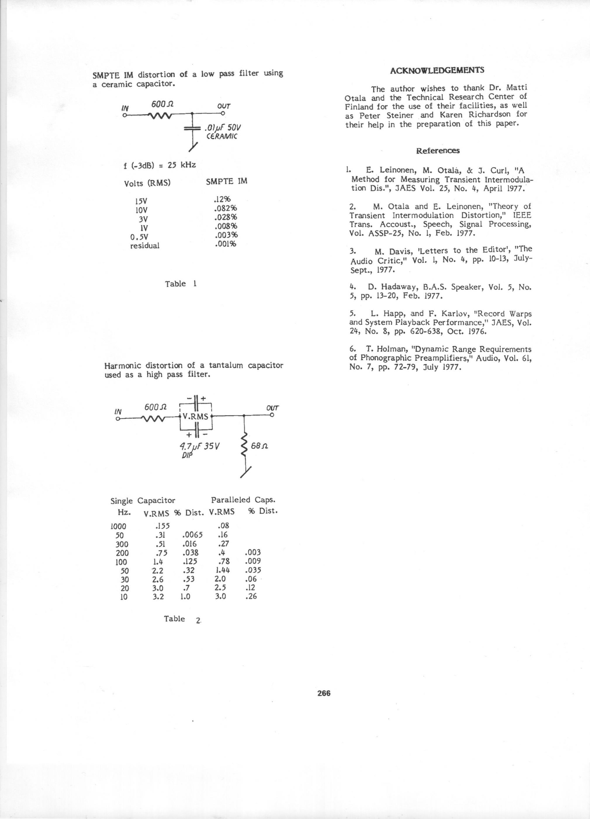

Here are some measurements from the past (40 years ago) that show the problem with ceramics and tantalum caps. When will we ever learn? '-)
Yes, when will we ever learn that you have to figure out usage cases and do proper engineering rather than cite something completely out of context from 40 years ago without looking at modern evolution of parts which are infinitely finer stratified for purpose than they historically were.
Pretty please stop trolling with out-of-touch-with-reality 40 year old documents. You're really a much better designer than that.
Of course, PMA has 'learned' but what about the rest of you? Why, when he shows measurements, do you ignore them? Why not just eliminate ceramic or tantalum caps with direct coupling or at least a modest film cap? That's what we professional audio designers do. Mid-fi (including Sony) is something else. Now you have a clue as to why much mid-fi has a 'sound character', mostly lousy parts.
