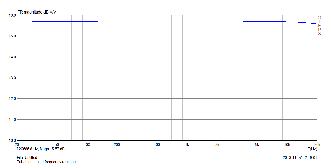

The question to ask is “will Pavel’s SRPP circuit be able to be done right to not suck out the midrange?”.
This is the frequency response in the audio band. It is extended to hundreds of kHz, with a -3dB roll off from flat above 300kHz. Rise time is below 1us. I am pretty sure there is no midrange suck out. It seems to me rather like a self-suggestion.
