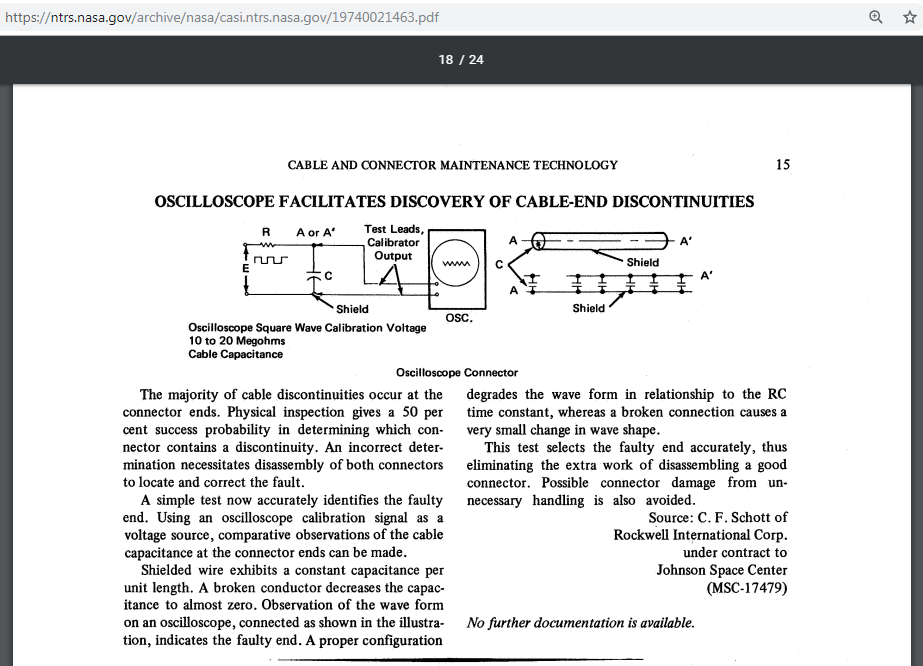

You think NASA cares about cable direction when they are receiving and amplifying the signal from voyager 1? The antenna receives 10e-16 watts. Why not?

One plausible explanation is that cables NASA use are satisfactorily usable in both directions. Moreover, I suspect that no more funding will be made available even if there is slightly better signal resolution due to cable direction.You think NASA cares about cable direction when they are receiving and amplifying the signal from voyager 1? The antenna receives 10e-16 watts. Why not?
Cable material and directionality are interesting subjects, but not interesting enough for me to justify spending large sum of time or money on. Knowledge of the true nature of the properties helps me enjoy better entertainment and avoid snake oil products. However, others may feel differently.🙂
They use ordinary cables for the most part. I've been there.
MIL-W-22759 specification
To the best of my knowledge (till some 10 years ago), cable directionality was not an enlisted part of any space/aviation requirement/specification

Only that verification of conformance to some NASA/MIL/Aero/BMS/SAE/EN….. specs costs a lot of money .They use ordinary cables for the most part. I've been there.

A plausible explanation is that all non-faulty symmetric cables are usable in both directions, but I guess this is not what you meant.indra1 said:One plausible explanation is that cables NASA use are satisfactorily usable in both directions.
Another less plausible explanation would be that there is a secret group in NASA which tests all system-critical cables for directionality. The group has to be secret because there is no explicit funding for it, so it has to 'steal' budget from other groups.
Or maybe someone just dowses each cable and pronounces which way it should be connected?

Close enough to what I meant, symmetric cables implies meeting specification when used in any direction and corresponding screening procedure ensure that despite variations, delivered cables meet specification upon usage. It is obvious that current technology delivers usable symmetric cables, but I am not yet informed that current technology can deliver symmetric cables so perfect with no directional asymmetry deviation whatsoever measured by any means.A plausible explanation is that all non-faulty symmetric cables are usable in both directions, ...
Perhaps managed under MIB with inter galactic funding? 😀... The group has to be secret because there is no explicit funding for it, so it has to 'steal' budget from other groups. ...
A cable which is symmetric or a tiny fraction of a wavelength in length, and contains no exotic materials cannot be directional. There is nothing to sense the direction of a signal, and nothing to do anything with that information even if it had been obtained.
For a really short cable (and almost all analogue audio interconnects are really short, in wavelength terms) even some asymmetry will not make the cable noticeably directional. If it could be shown that a particular cable really is directional then the first place to look is asymmetric faults, such as solder joint and mating surface resistance differences or shielding quality.
