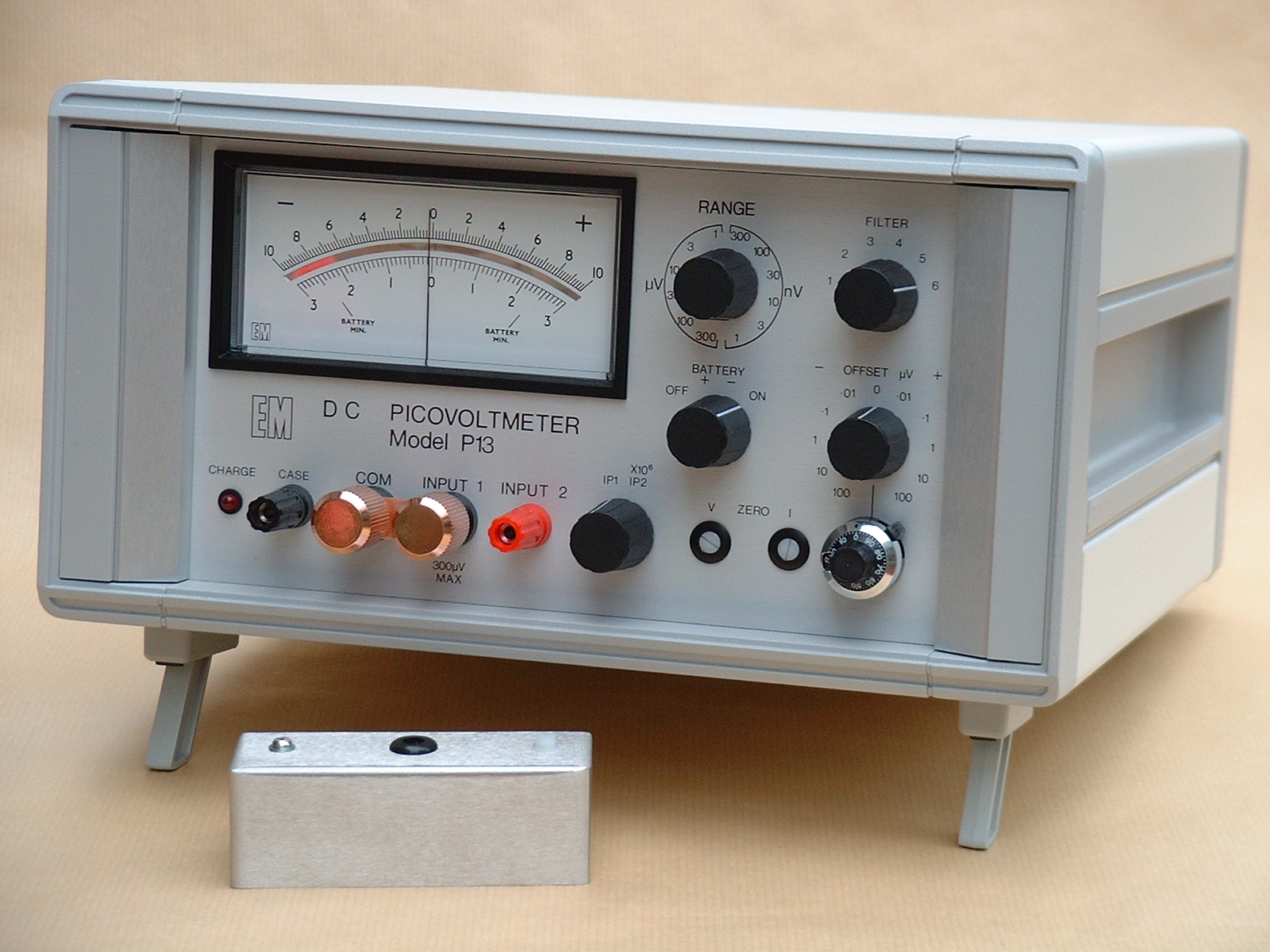

Thermal effects can be observed but as I pointed out to Ed the problem becomes a multi-physics one and clipping components in and out of a sky-wired breadboard does not cut it. Note connectors below.

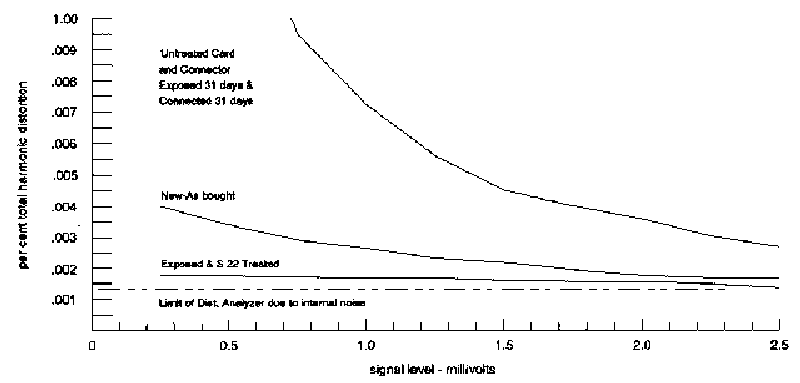

Stabilent 22 for low level signals.
Lowers distortion by contact enhancement without shorting adjacent contacts.
Upper curve is pc board connected after 31 days of free air exposure.
Middle curve is contacts when new.
Bottom curve is exposed contacts treated with Stabilent 22

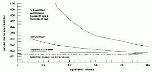

Yes, oxides again. and double the numbers for a cable with 2 connectors... plug and jack. Plugging and unplugging just varies the contact R. cleaning them and applying stab 22 to keep oxides from forming is best way .... So maybe not directional cable but 'different' when changed.
Hard gold plating is used to prevent oxidation of the base metal. But keeping pollutants et al from them requires cleaning. And a plug-jack that makes air tight connection at the contact area. Many RCA style do not do this.
