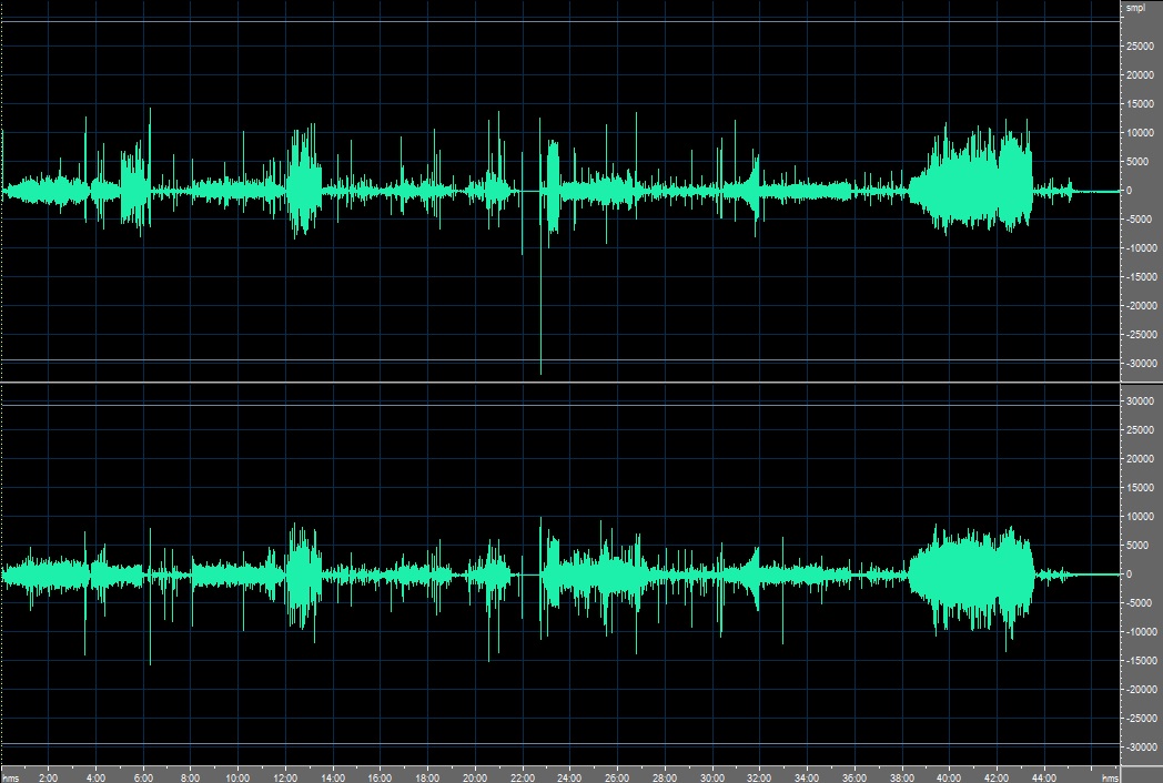

My no feedback all FET one sounds fine to me. ULD for phono why bother? Open-loop phono is inherently bandwidth limited so slew rate is virtually meaningless. People tend to overlook the fact that ticks and pops are not pre-emphasized so are much less of an issue than some think. See plot of both sides of a well made LP, only the needle drop (and here it is a drop) near the middle even pushes the limit. There is nearly a crest factor of 10 but only 2dB headroom lost to pops.
Note - this plot is 45min long so each point represents about 350,000 samples and the peak value is displayed so no peaks are missed but the width of a tick or pop is visually exaggerated by 350K.

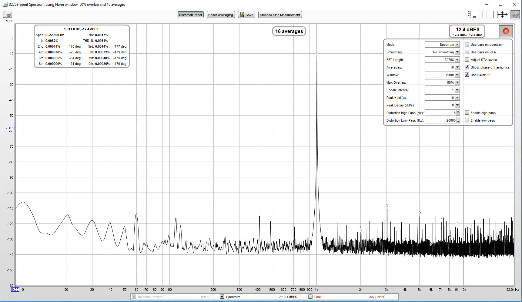

I am working on a cross-over filter to replace the existing Crown amp/filter for the M2. But instead of using analog opamps, I am using DSP (miniDSP) instead. It has been well known and published in AES by several authors that there is a distortion rise approaching the corner freq using typical opamp type circuits. I was reminded again by D. Self in his new filter book. The DSP method doesnt do that.
View attachment filter dist 3.PDF
The miniDSP with output opamp changed to OPA1612 has harmonics at -120dbv..... almost good enough ;-)

It won't connected to those DAC's. You could socket it and start rolling and add to the metadata unless you want to DBT (which I know you won't do).
More papers from the days of uA741's, 301's, etc. you need an update.
Error correction line #7273 .... OPA1612 is on the input. My comment is 'measured' results.
Update doesnt change the results of those analog filter configs.… as recently also shown by D.Self in his new filter book.
The miniDSP also does any needed EQ. 🙂 I'll get all the coeff of the JBL filter and use them.
Intermediate test is to tap out of the Crown amp/xover at it's amp input and use new analog amps. Eventually, to be replaced with miniDSP and new analog PA.
-RM
OK then the A/D or are you using the miniDSP in bypass mode? George has already done some measurements IIRC. Or you could see Tom's (Mr. more zeros is better himself) MiniDSP 4x10 HD Performance Measurements.. I doubt the op-amp swap would make up the difference.
