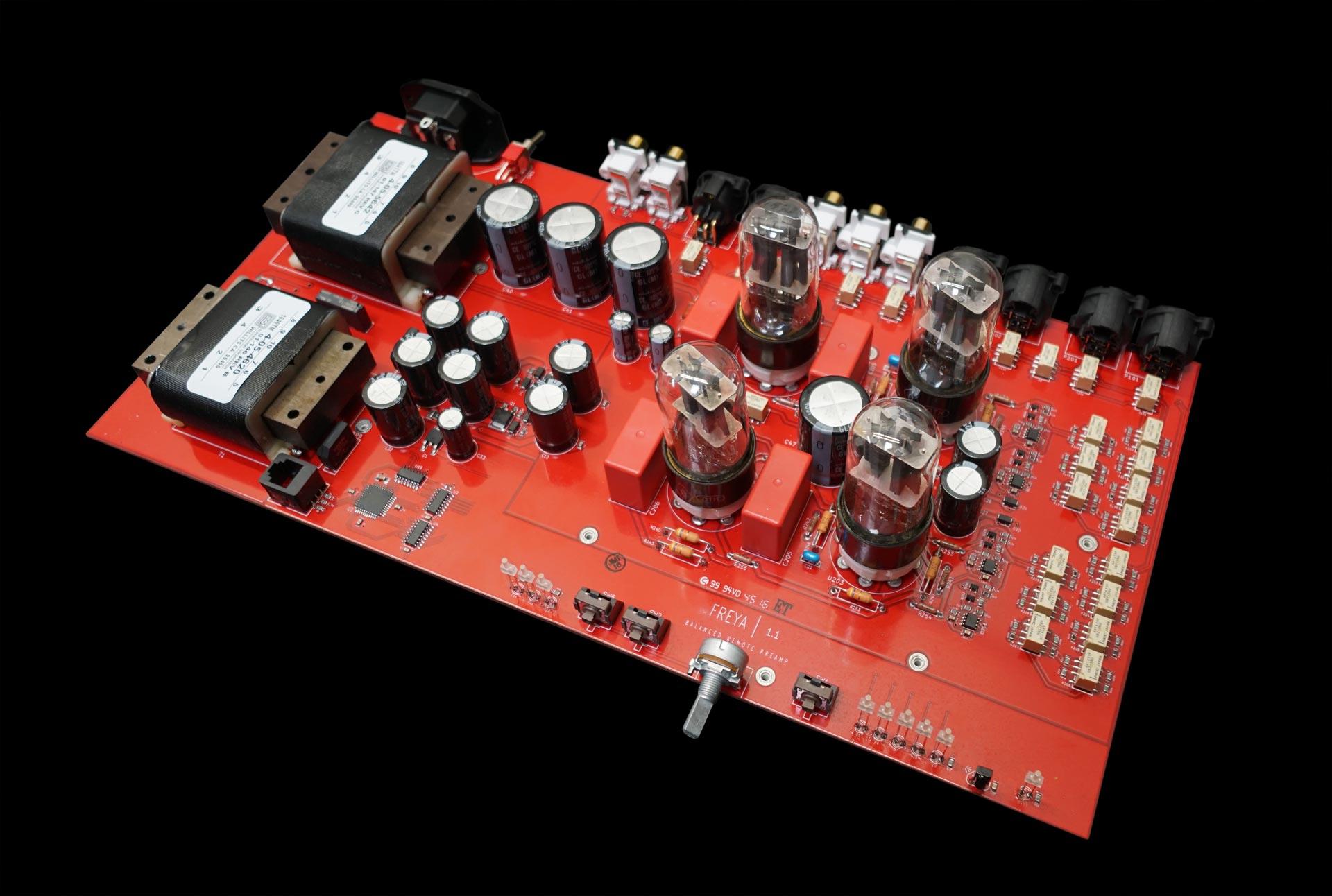

That's a funny thing to say, many of Nelson's projects reject obeisance to things like THD, etc. IME these circuits have clear colorations and are not by strict definition "accurate".
It's another "like" flavor fan club. Those high bias/class-A need expensive large area heat-sinking. The machining/metal work is very expensive..... i ought to know.
