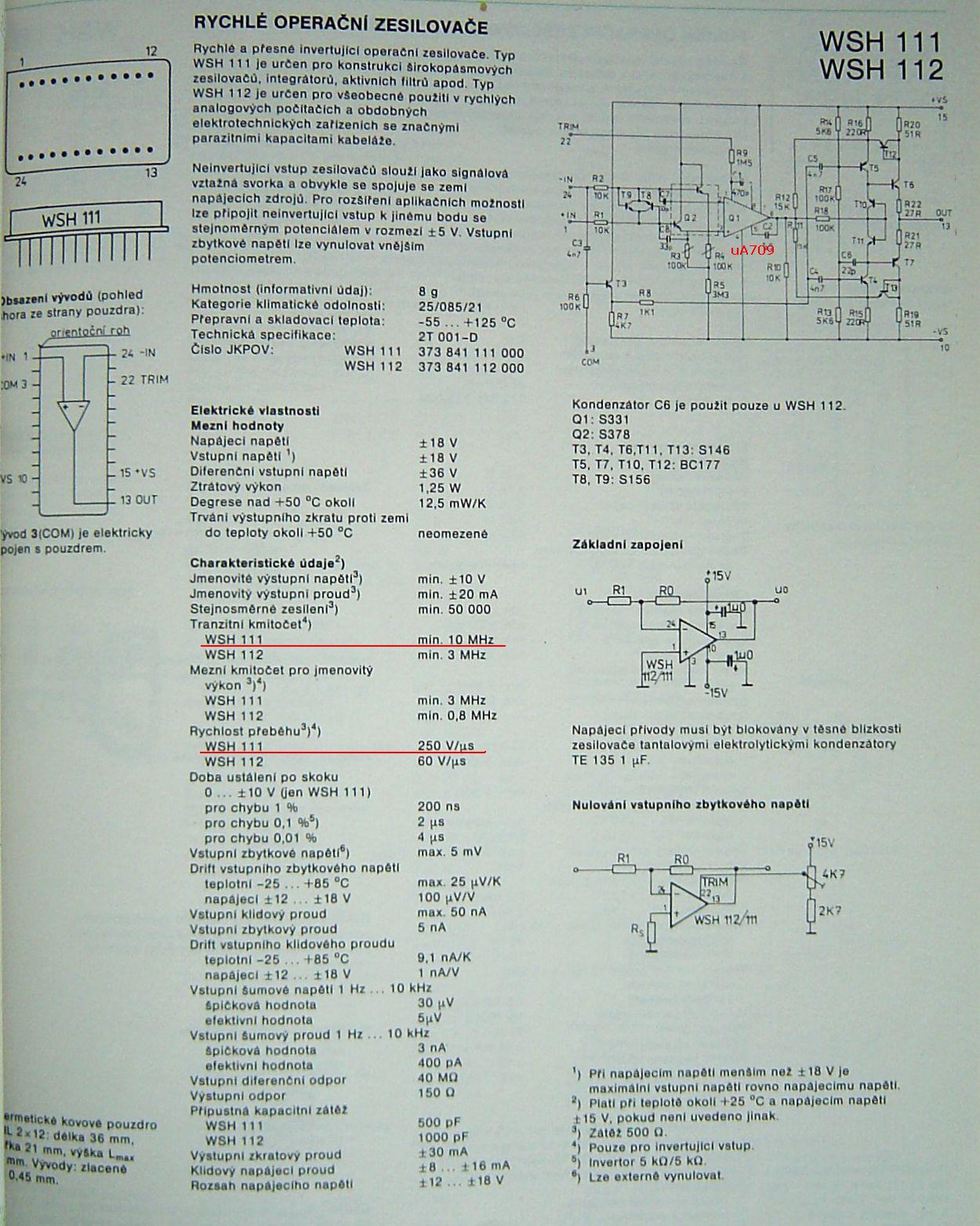

Certainly one of the pleasures of the HA-5002 is the fact that you can only buy it in surface mount. Keeps out the "proud to be a lame old fart" riff raff. I suppose I am willing to sell one of my (thru hole) HYBRID parts from whom the HA-5002 descended, namely the (in)famous LH-0002 "diamond buffer", but the bidding begins at USD 300.00 plus shipping and insurance. Got a couple 033s and 063s too but it'll take a boatload of cash to induce me to let go of them.
Ha. Is that some sort of ancient amp in a can? Germanium in oil for ultimate fidelity, I hope.
Almost so. It was a fast inverting hybrid amplifier based on uA709, buffer output stage + fast parallel branch. 250V/us, fT 10MHz, settling time 200ns/1%. Late seventies of 20th century.

PMA, thanks for the 'dated' spec sheet on a 709 hybrid. This schematic shows true design engineering, converting a usually very slow IC with other problems to something that is really elegant. When I first worked with 709's in 1966-7, we were designing military equipment too, but we did not enhance them. Later I switched to the uA741, which was perfect for the tape transport servos that I was designing, but of course, these parts were lousy for relatively high speed instrumentation or even audio. Back in late 1967 when I moved to the Ampex Instrumentation tape recorders division, I recall another engineer trying to use the uA709 for instrumentation tape recorders and he gave up in frustration. My regards to the (Russian?) engineer who made the uA709 into something more than it originally was.
