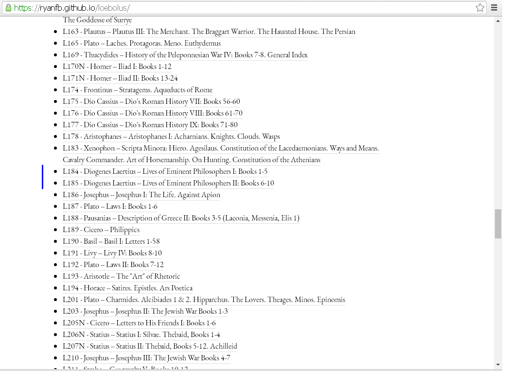

I’d love to see philosophy sensed and experienced as a not scholar entity, rather as a living process (like spoken language). The same experience drown out from reading Diogenes Laertius -- Lives of Eminent Philosophers
George
