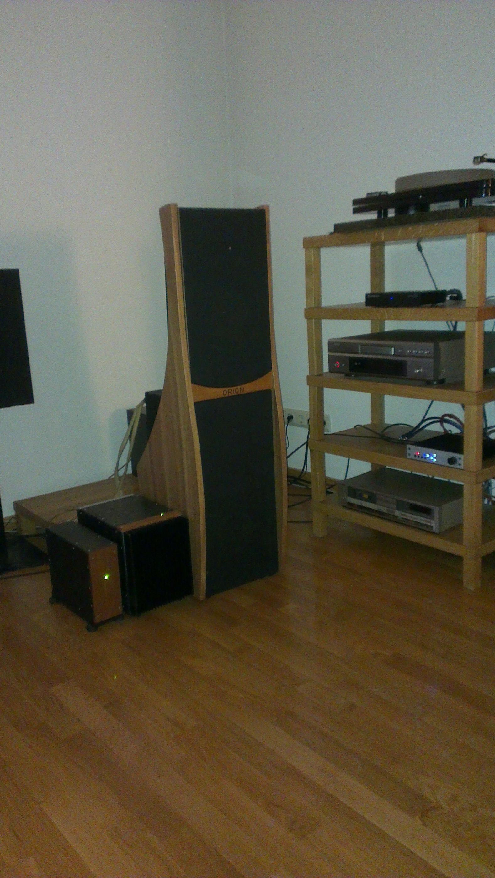

Today I was listening to my 100w CFA amps(three channels in each amplifier) driving ORION loudspeakers. The source was one of the best dacs, Benchmark DAC2 directly connected to the analog electronic crossovers acting as a preamp too.
I can say I am very satisfied with the sound, filling very close to live performance (classical music, as I go on classical concert only and could compare with it only).
What a coincidence. I just listened to the higher power version a couple days ago. OMG! I never heard such pin point imaging and front - back layering. Wow. Amazing. I love it. I will assume that is due to the characteristics we talked about and how nothing changes during tests.
It is really nice feeling to suggest trying CFA and to understand the differences and even with high SR and take up the challenge by several here at DIYAudio -- all with excellent performance.
