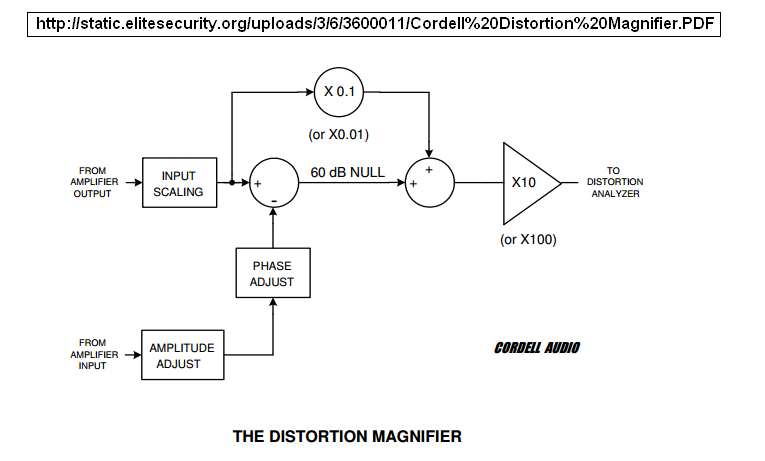

If you use even the most simple distortion magnifier, such as Bob Cordell's any sound card is more than adequate for the task.
May I ask what is the purpose of injecting a fraction of Amp-out past the nulling stage?
Also how phase adjustment is done when the test signal is not of a single frequency (say a dual tone 60Hz and 7kHz)?
George

George -- I believe that was for older distortion meters that needed (albeit attenuated) fundamental harmonic in order to lock on and produce a THD+N number. With a sound card input, absolutely no need for a re-injection.
Can't help with the phase adjust part, though. Best fit?

I had a very simple distortion magnifier from some decades back to use with an oscilloscope (2 transistor long tail pair, single ended amp, resistors & capacitors, Wireless World, Circuit Ideas).
Now, when using a sound card to record the input and output signal, everything can be done in SW through a wave editor.
Phase invert one channel (if needed), synchronize (thus the question for phase adjust), equalize amplitudes, save as mono, sw amplify. It is around a 10 minutes work.
