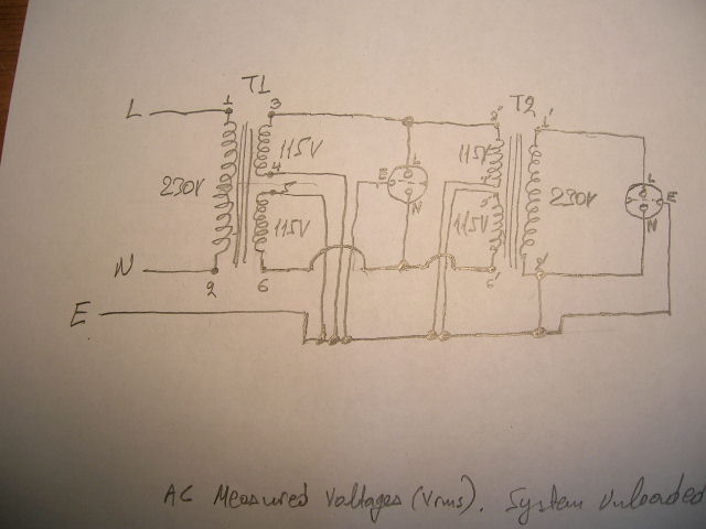

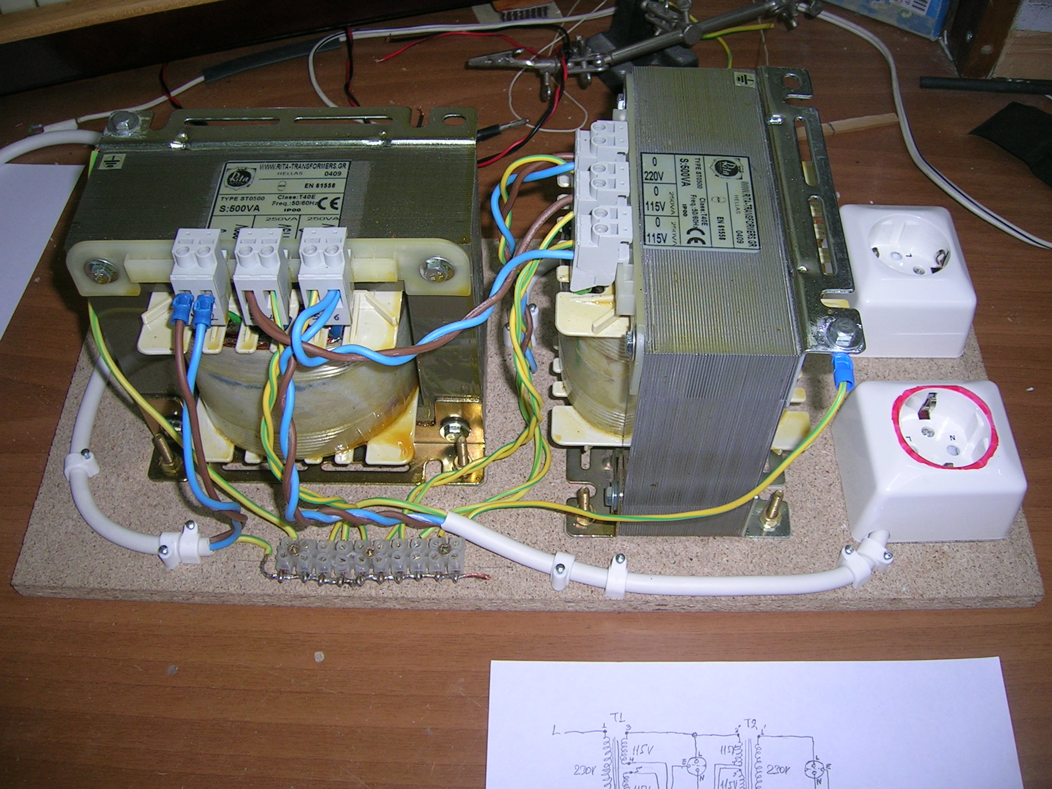

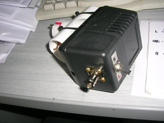

Some old tests with back to back isolation transformers (non shielded).
The “Live Probe” schematic is from a “Wireless World” article (sorry, I can’t find year/volume number/author)
George
George

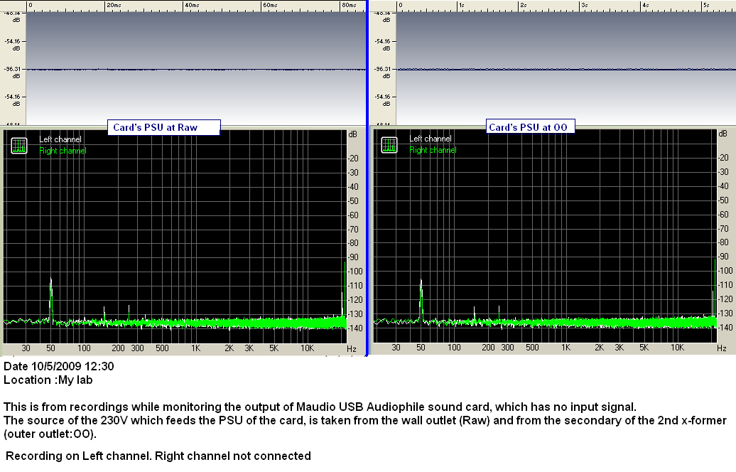

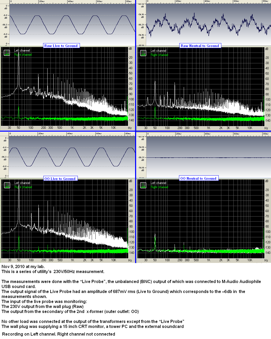

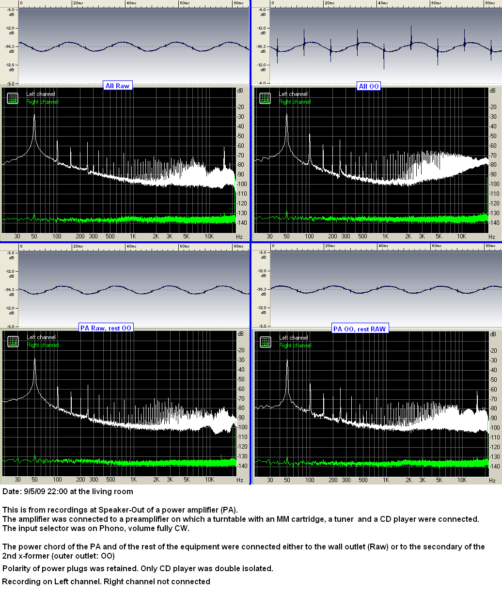

Looks like a good and safe test method without using a specialized probe system.
Lots of noise shown in the audio band. Dont know the noise source(s) or if that is worse case or not. Now if you just throw a Cap across the secondary lines, it will cut that down a lot.
Then power something with it (DAC, preamp) and Listen again.
THx-RNMarsh
THx-RNMarsh
