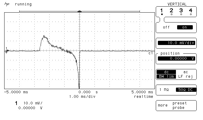

Not sure where you have been looking, but I thought some pretty pictures have already posted here.
Attached is one of my old ones showing noise riding in from the AC power line while the power supply rectifier diode is conducting. If you do the arithmetic this amount of noise will increase the noise floor to a level that may be perceptible depending on the loudspeaker's sensitivity (efficiency) and the listening environment noise floor. (About 29 dB spl without any gain or power supply filter loss for a small cheap loudspeaker. 46 dB spl with a horn and 19 dB spl with a low efficiency unit.)
Yes there is filtering for the expected 120 hertz ripple but it in a lower production cost power supply is almost useless at 6,000 hertz where the hearing of humans is most sensitive.
