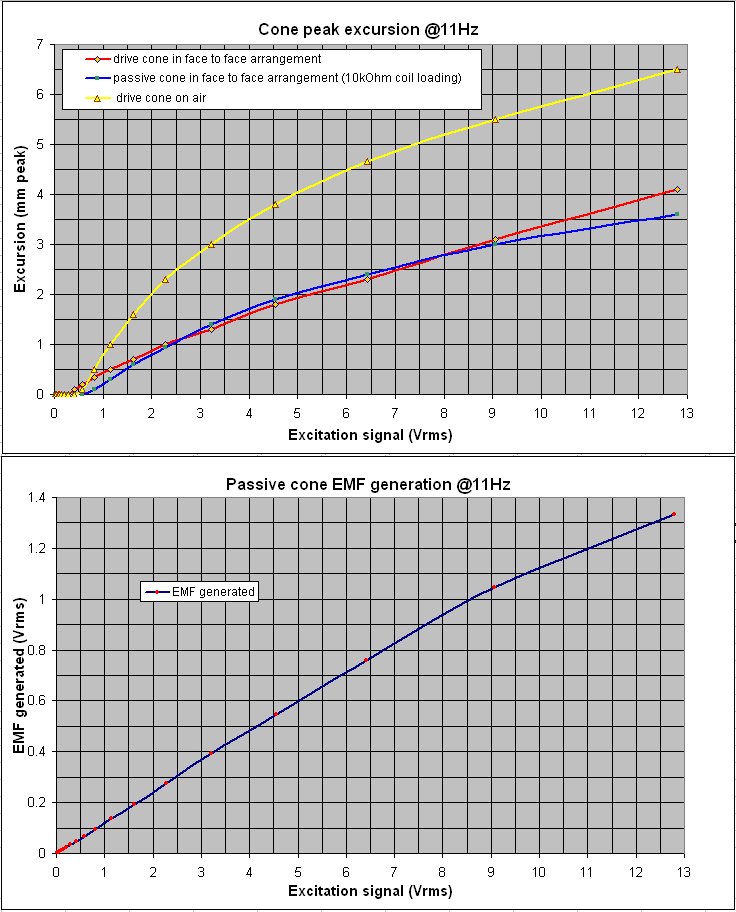

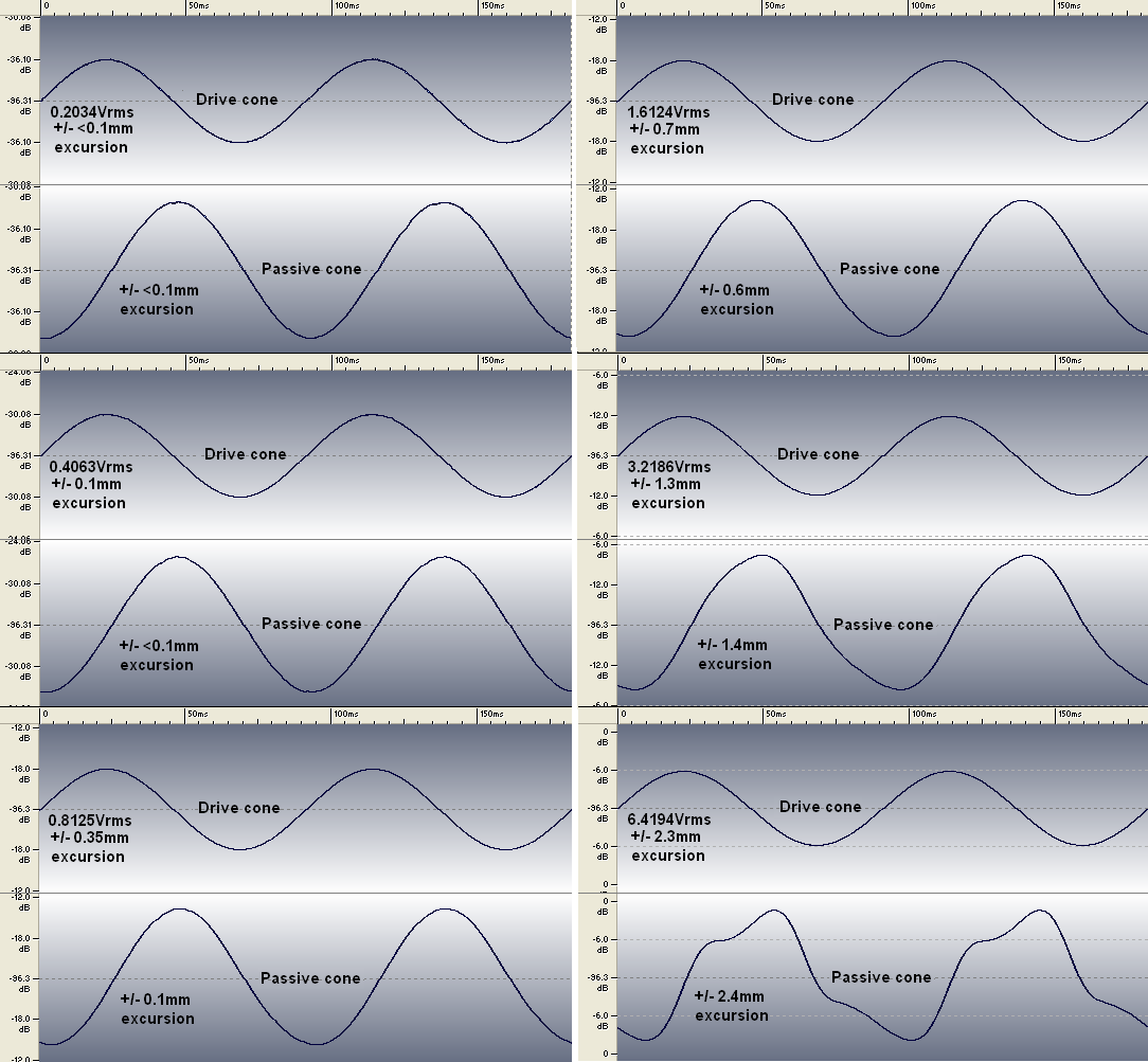

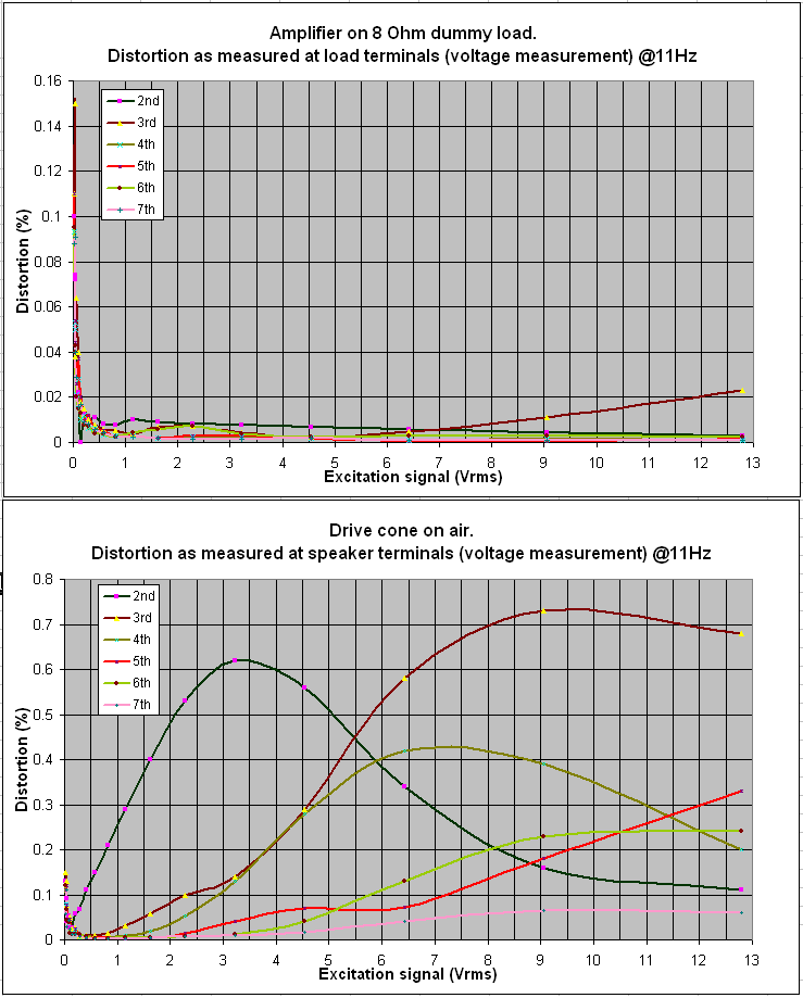

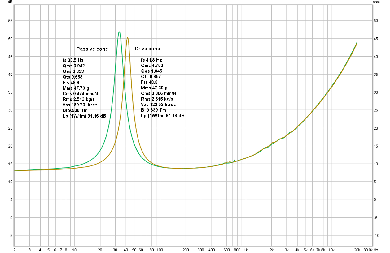

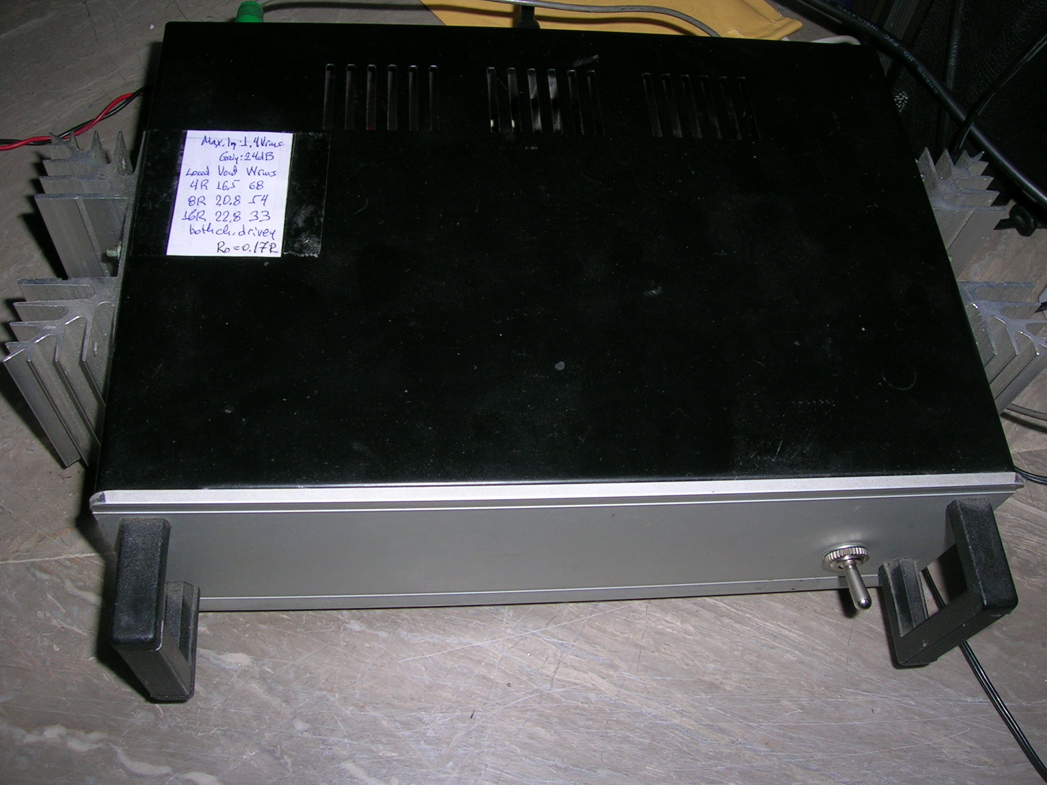

I put the two 12 inch drivers (same P/N but specs don’t match very well) on the bench for some more organized measurements.
Enclosed air btn the two cones has a volume of 1.86lt.
The voice coil of the passive cone is shunted only by the Ro of the soundcard (10kOhm).
Drive to the other unit is via an LM3886 amplifier
I think that with these drivers, the distortion seen on the EMF of the passive cone is to be attributed not to the minimal compressibility of the air but to suspension nonlinearities and may be to magnetic nonlinearities.
George
