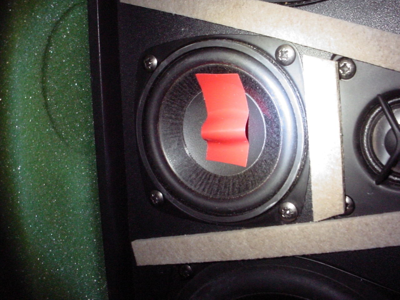

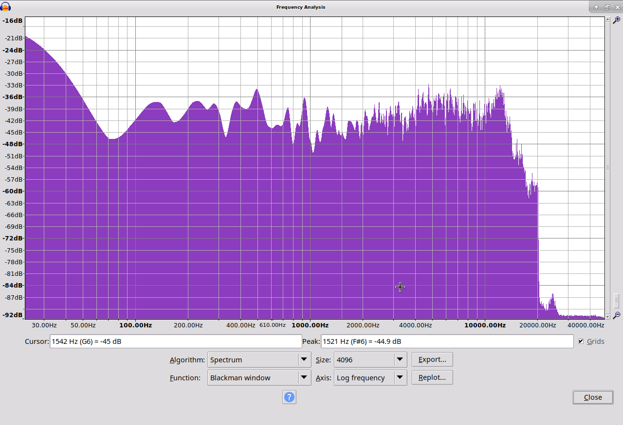

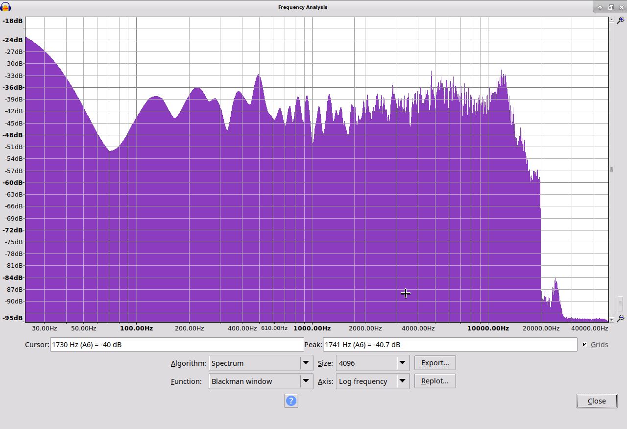

Here are the before and after FFTs for the caterpillar phase plug mod. I'm no expert so I could be drawing wrong conclusions about what is shown, but the effect, at least on FR, seems positive. I didn't notice any harmonic strangeness when looking at the spectrogram. I removed the tape to make the without measurement, so the picture does not show exactly how it was. the tape is scotch 35:

Do a water fall plot... see if it is a resonance. I think you will have better luck modifying that surround. IMHO

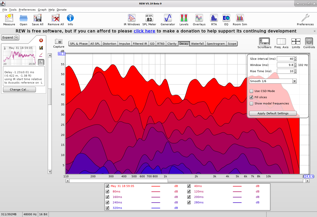

I don't have anything that can do waterfall plots. Is there some free software that can do it?
Thanks. I managed to get it working. Unfortunately waterfall plots don't seem to work in Linux. The decay chart shows a notable resonance at 12KHz but nothing I can see that is comparable at 1KHz. I guessed based on my meager knowledge of FFT stuff but these settings may not be optimal for trying to see this.
Here is a plot that seems to make more sense for the midrange.

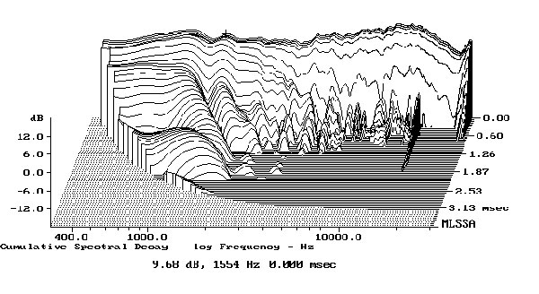

it helps a lot to look at other measurement samples to see what to explect. This random example from Stereophile: https://www.stereophile.com/images/618EggAndrafig7.jpg is a start. The total time window is about 4 mS and the steps are maybe 20 uS.
I have encountered similar resonances in drivers and they are usually structural in that they can't be removed simply. In the midrange the 12 KHz may be due to the shape and size of the cavity in fron of the diaphragm. Or maybe the bell mode resonance of the diaphragm. In any case a high Q notch at the resonance may be your best fix.
