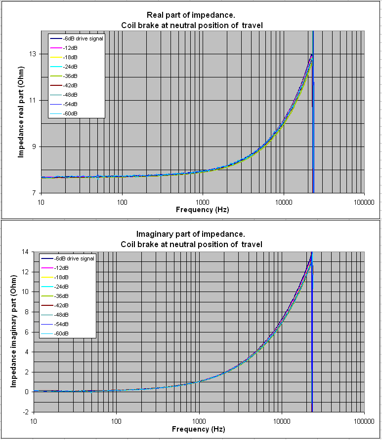

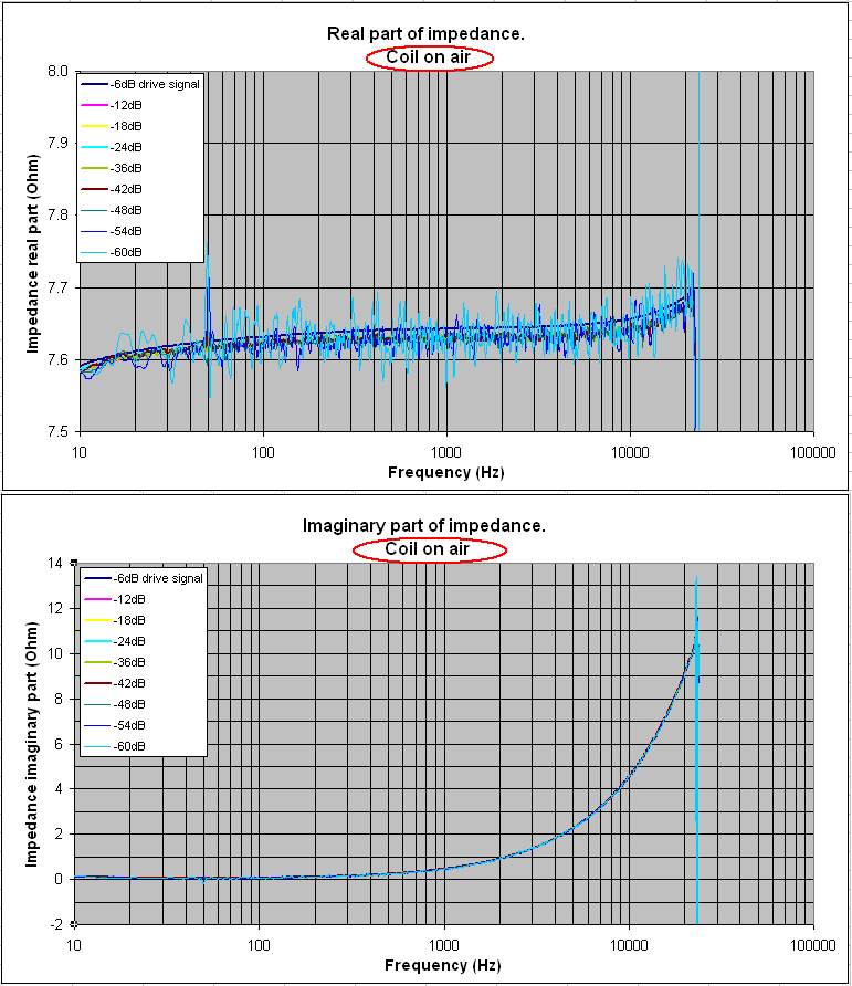

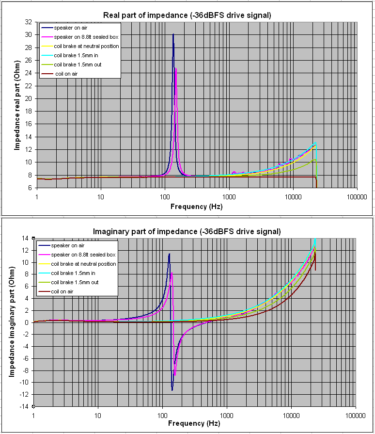

To elaborate, locked rotor measurement of Rs vs frequency vs location.

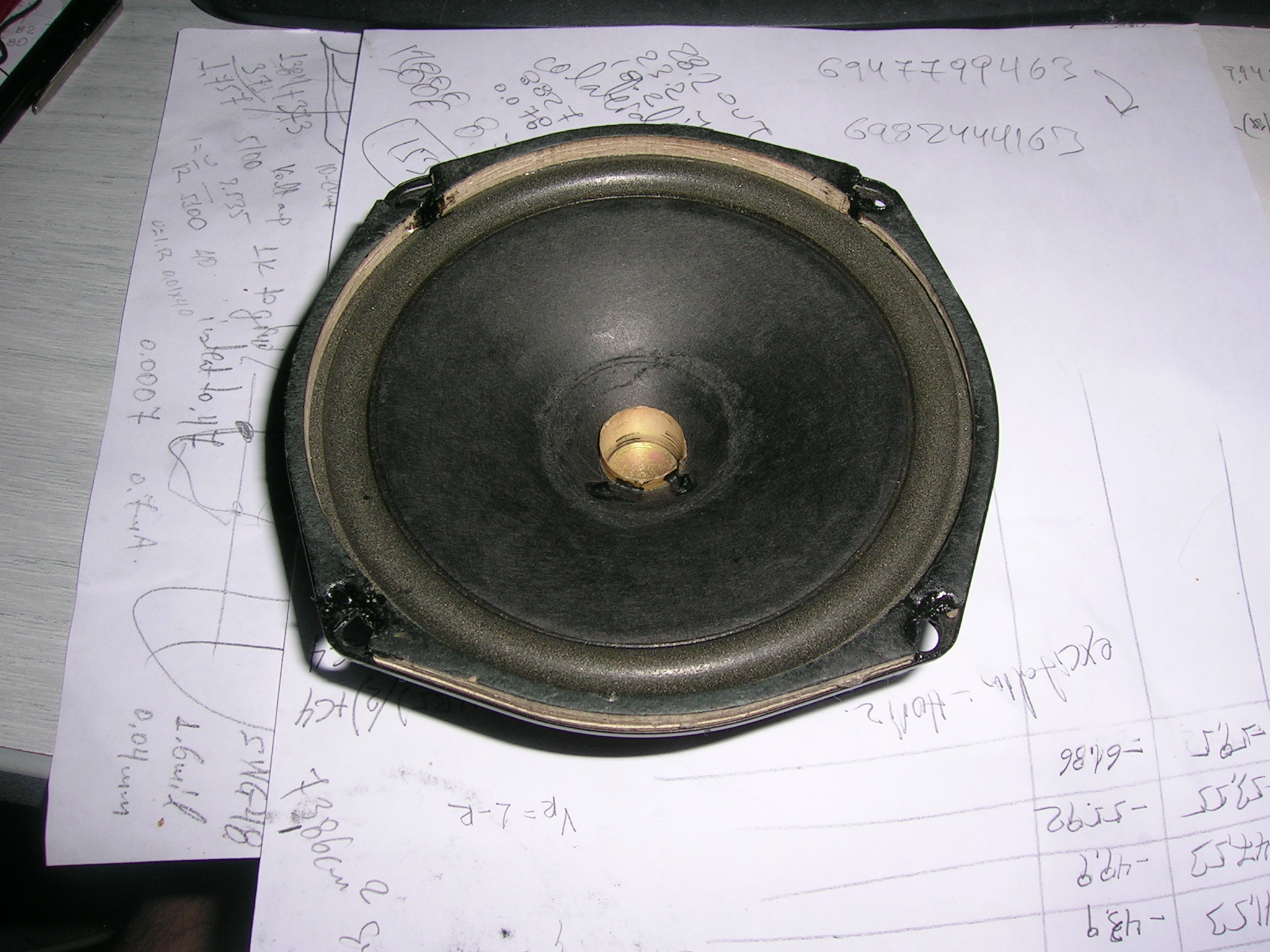

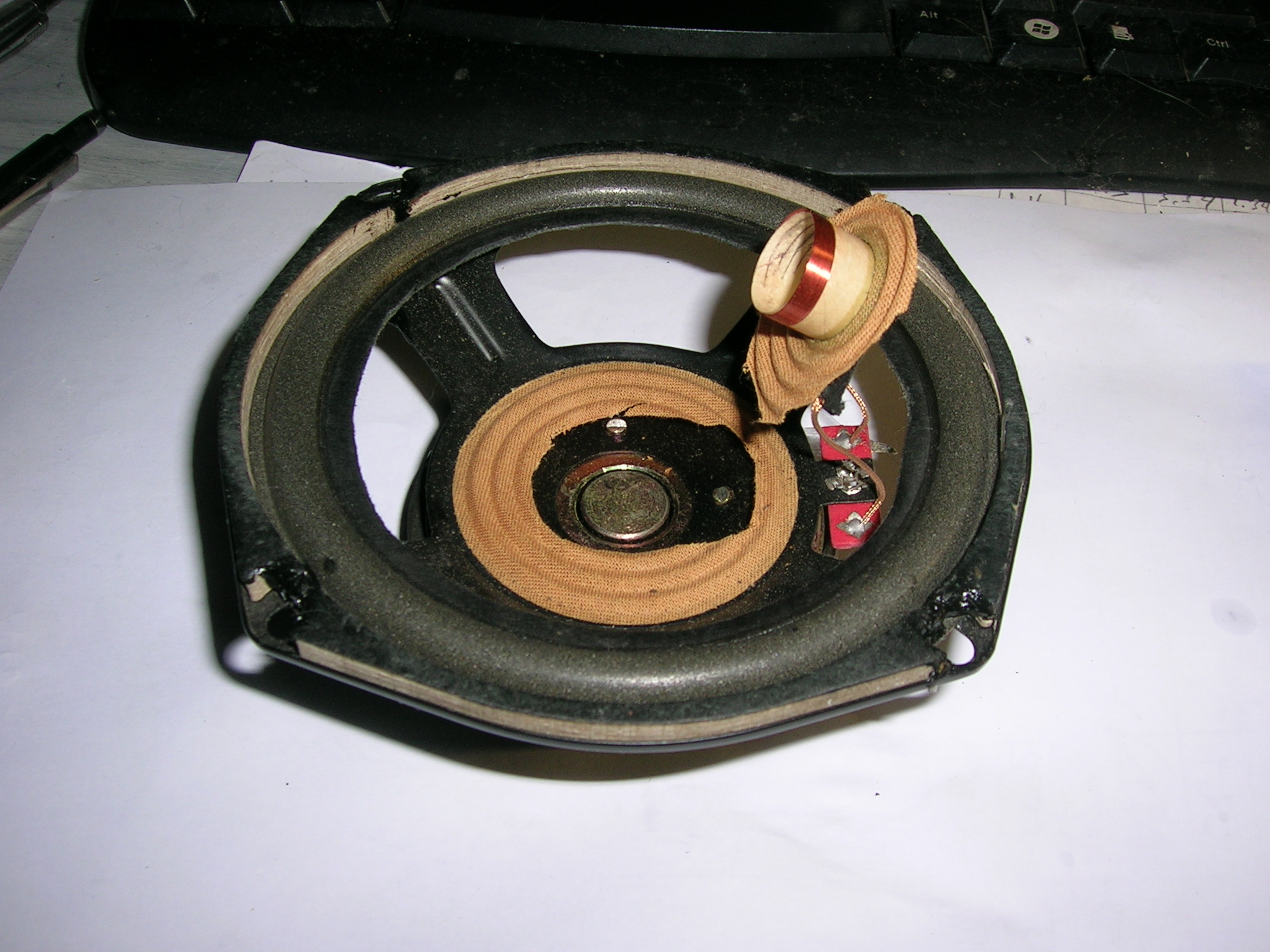

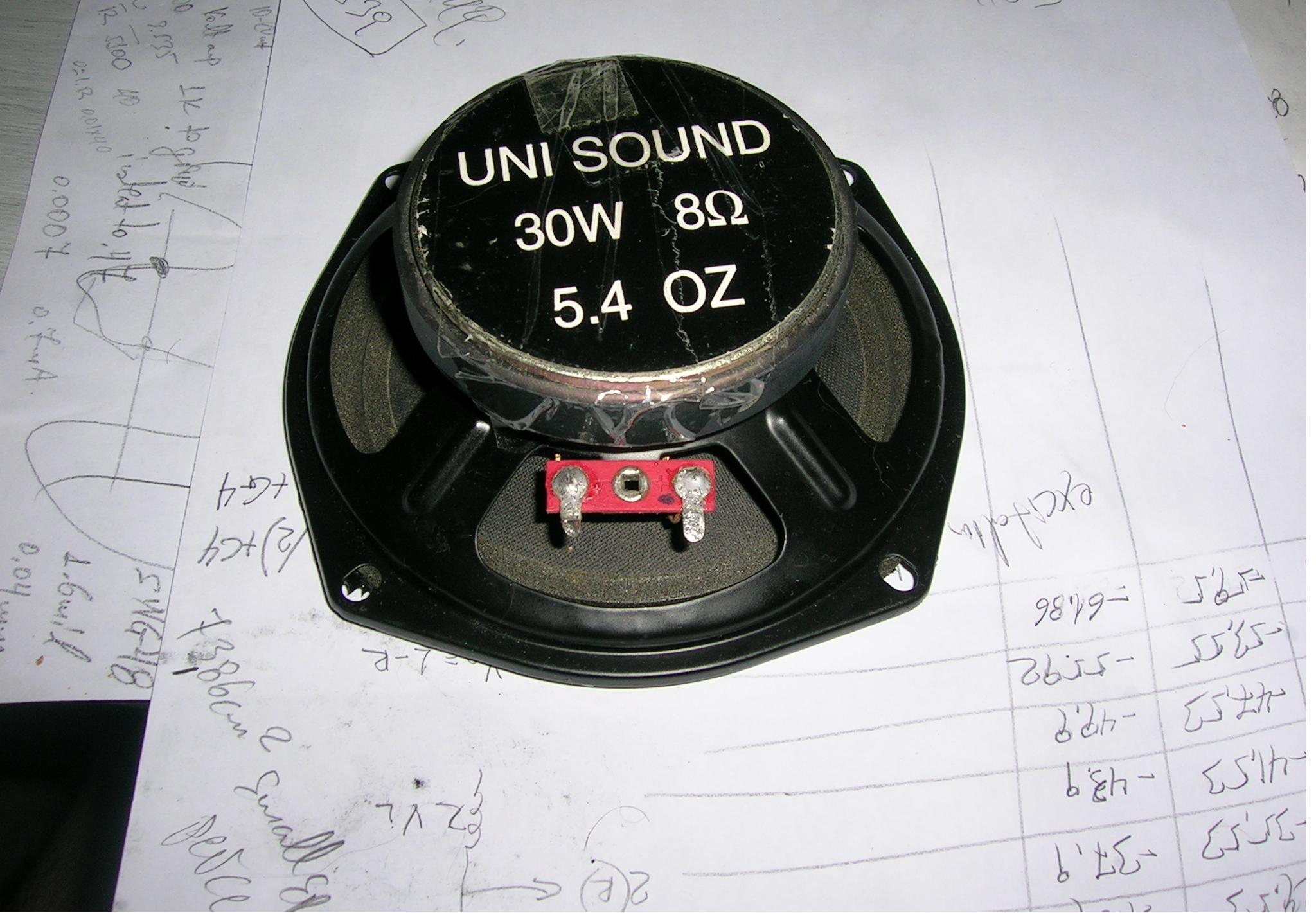

Here is some data from a cheap 3.8inch cone car driver with a 5.4oz ceramic magnet.
gap height=2.6mm
coil height=3.5mm (slightly overhang)
coil inner diameter=15mm
paper coil former
If there is something else you want me to do with this humble motor, do not hesitate to ask it
