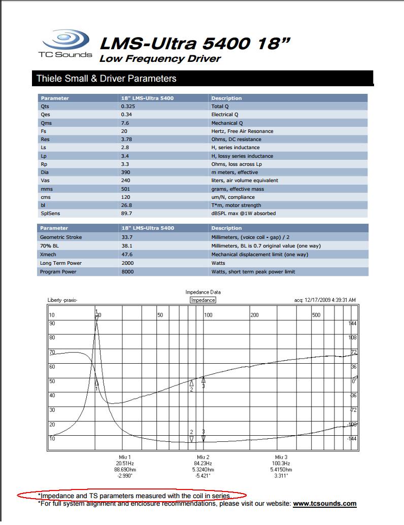

Richard, the two expensive and good drivers you have purchased for your subs are dual voice coil ( aluminum wire, 4” diam stainless steel coil former).
http://www.diyaudio.com/forums/atta...s-blowtorch-preamplifier-iii-richards-sub-png
You have the instrumentation to test the magnetic coupling between the two voice coils and study the effect of this in this application.
You can even remove the magnet assy and look inside
