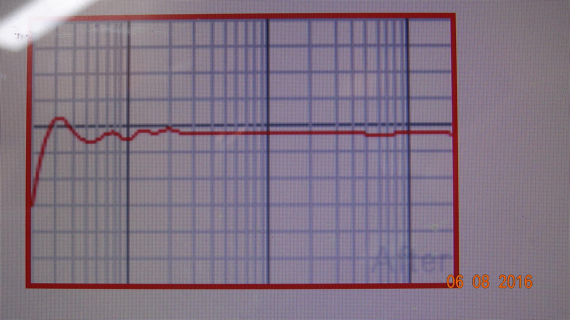

.... and here is a corrected or EQ'ed response for an other headphone.

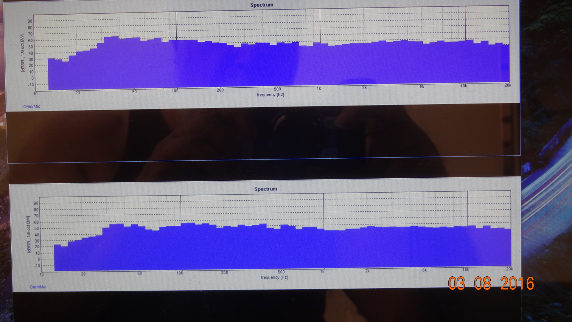

Speakers are a serious problem for those who do not like to have a lot of room interference patterns in their sound. peaks and nulls. Reflections. So, can you get flat or reasonably flat and thus more accurate frequency response with widely spaced and far back in a room> usually not. Especially, below 500Hz you get wild variations. With a few exceptions you need to have control of the dispersion. The wide dispersion is a disaster for far field room listening.
Here is how controlling dispersion and care to prevent early reflections and attenuate them can produce a pretty good freq response and excellent imaging with speakers 12 feet apart and 15 feet into the room as the listening position; with no EQ applied:
JBL M2
However, the best solution is to listen to the speakers near-field and with headphones; both, can be used to compare.
THx-RNMarsh
JBL M2
THx-RNMarsh

That's the real bottleneck of audio reproduction, not amps and DACs.Speakers are a serious problem for those who do not like to have a lot of room interference patterns in their sound. peaks and nulls. Reflections.
Finally. Thanks for sharing. Is that where you and Markw4 auditioned DACs a few months ago?Here is how controlling dispersion and care to prevent early reflections and attenuate them can produce a pretty good freq response and excellent imaging with speakers 12 feet apart and 15 feet into the room as the listening position; with no EQ applied:
yes, just closer distance listening (near-field).

Looks like the low octave needs work, bass traps, location rearrangement or subwoofer augmentation.yes, just closer distance listening (near-field).
Any other measurements of the room?
