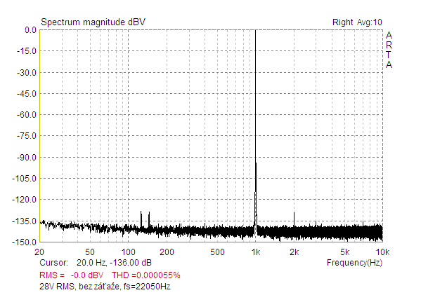

Measurements are not my opinion, but a objective fact. But feelings are pure subjective "opinions"..
And using capacitor in low and high pass filters aplications (signal AC voltage across cap) have nothing to do with using the same capacitor in coupling function. You have simply to select proper parts for each aplication.
We have to distinguish linear (e.g. BW manipulation) and nonlinear distortion in audio band..😉Linear distortion will be caused even with ideal capacitor. We are talking till now about nonlinear distortion "caused" by (properly sized..) coupling capacitor.
In attached picture You can see "distortion" caused by elyt coupling caps at input and in feedback arm in my amp. 28V RMS output (so quite full voltage swing), no load at output. So no output stage distortions.
