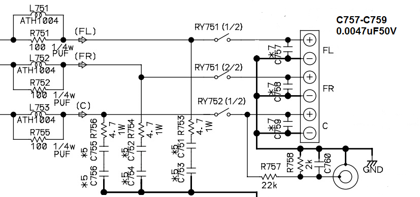

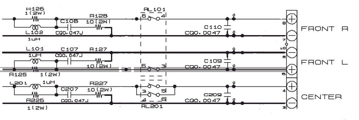

The 6th edition of Douglas Self's book, Audio Power Amplifier Design, includes an entire chapter called "Output Networks and Load Effects", pp. 355-385. The science behind the component values in Zobel networks is discussed there.
Thanks, but the 5th edition I have info here does not match the schematics below which have single Zobels downstream of the output inductor and upstream of the output relay, also there is large variation in the values for the output inductor damping resistor.
It seems there is no real consensus on output load compensation network values nor network circuit location.
Anybody else have useful info or experience/test measurements ?.
C751-C756 0.22uF/50V

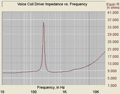

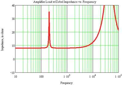

IC Audio Power Amplifiers and Zobel Networks: One Size Does Not Fit All
This article discusses IC amplifier single FR driver application, the danger of overshoot voltages due to under compensation and shows graph of single driver Z/F using standard Rule Of Thumb zobel RC values.
VCD Z vs. Frequency (measured).
VCD Z w/Zobel network vs. Frequency "Rule of Thumb" Values (calculated).
So, FR drivers/boxes need RC compensation.... in past experiments I have found FR drivers to sound much cleaner/clearer with zobel compensation.
Typical two and three way loudspeaker impedance curves are of course different to single FR loudspeaker, anybody have measured Z curve values for standard/consumer 12dB/oct 2 way (say 8"/1") loudspeakers please ?.
