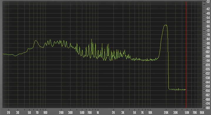

An example, albeit one of yet another upsampled "hd track"
Are New HD Downloads Really Hi-Res Music? | Real HD-Audio
I'm so confused why this is controversial to anyone but Richard, who thinks he's actually getting any value from he tracks? Are you taking exception with the shaped noise part or the dithering along the way as intermediate tracks get flattened? I know there's some arguments about flat vs noise shaping there, but anyone who doesn't dither tracks along the way will have huge truncation spikes! Well, unless the inherent noise in the track is high enough to act as its own dither. It would be impossible to see in a final spectrum as the final down sample will dominate.
Like this Dvorak ("192/24")remastered from original Studer A80 Master Tape? 😉

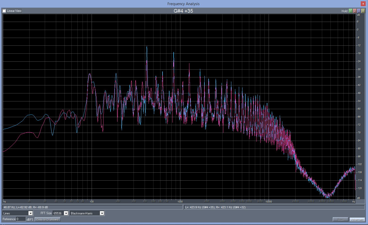

What a pile of .. nonsense.An example, albeit one of yet another upsampled "hd track"
'Spike is probablly (yes, with two L's) analog tape bias'.
Right. Bias. At 40kHz. In this day and age. Does the author understands what he sees in his analyzer window?
The article is probabLLy™just another clickbait.
Now, DPH, this is how agressively noise shaped dithered 44/16 material upsampled to 96/24 would look like. (That's an excerpt from very quiet passage). Got any similar examples from Hi-Rez material you were talking about?
