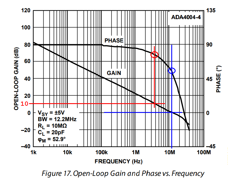

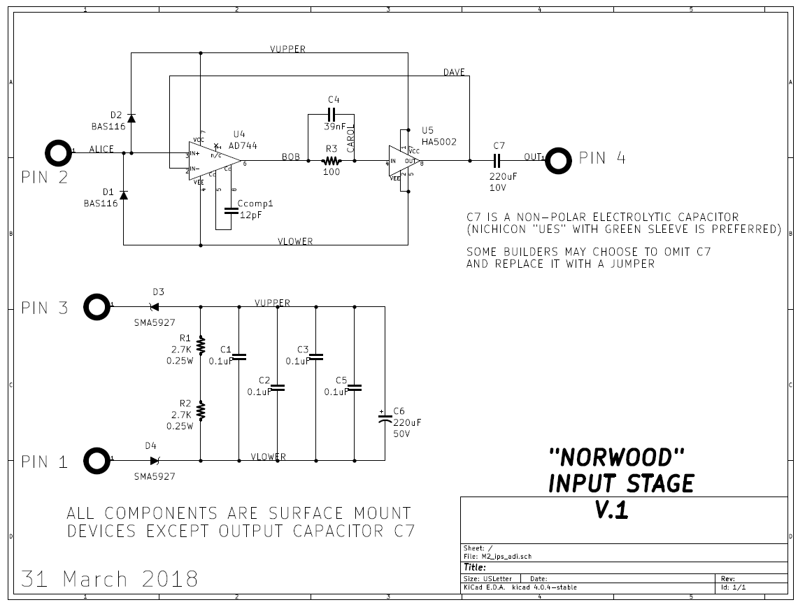

The M2X "Norwood" circuit is a power buffer using a composite amplifier, and it's so modern its components are surface mounted. Better yet it uses a Scott Wurcer opamp (AD744) with external compensation so you can tweak the gain and phase responses however you please.

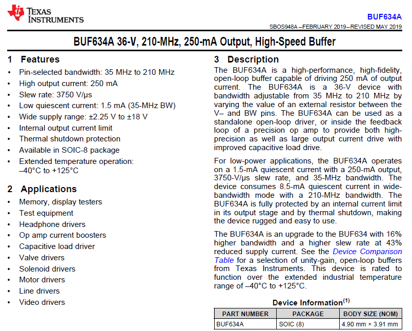

Of course you can drop in other opamps and/or other buffers if you wish. The newly redesigned TI BUF634A is a promising candidate.
Nelson Pass offers some general purpose good advice that's worth considering IMO: install a 3-to-1 attenuator at the input, and then run the composite amplifier at a loop gain of 3x (+10 dB), which buys you many many additional degrees of phase margin. Some of which is needed to combat the phase shift in the second half of the composite amplifier, and some of which is needed to combat aggressive opamp manufacturer's optimistic claims of "unity gain stable".

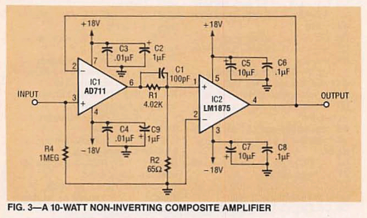

Thank you for the pointers Mark. I need several 8 - 25W buffers. Scott's 10W is directly usable and simple enough. For higher power I'll try NP's trick you mentioned or bootstrap easier to procure opamps before going the route of OPA445 or other jfet input hv types. Whatever does the trick.

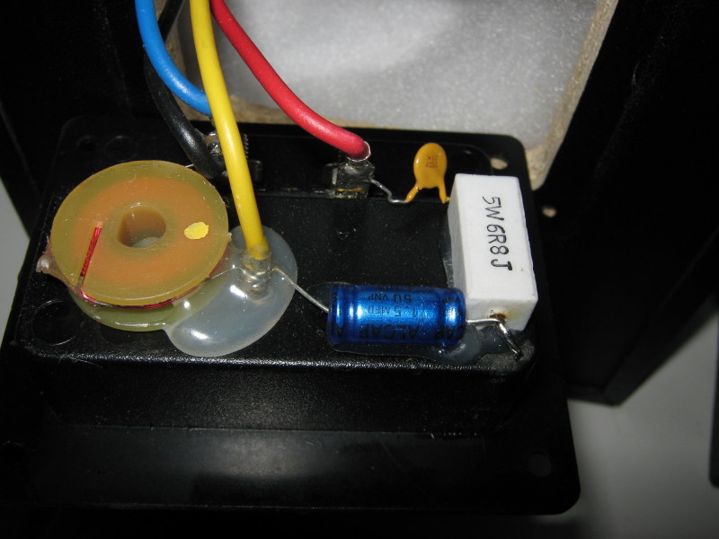

The other day a pair of Wharfedale Diamond 6R speakers came my way for free.
On first listen in conjunction with good powered sub nothing special to write home about but application of a bit of Goop placed around the four wires from crossover to the drivers changed everything about them and the drivers and speakers now truly disappear.
The woofers are wired direct and the tweeter is attenuated before 12dB CL filter as per the pic but no tweeter protection PTC.
It is a long time since I have lived with such arrangement and I must say the clarity and intelligibility is outstanding and the power handling is clean all the way up to bottoming the voice coils....oops.
In the next few days I will experiment with changing out the series cap and see what improvements can be made.
Interesting detail: it shows a large 1 meg input resistor which led me to have a further look at the spec sheet of the 711 and this shows the strength of a Fet input stage: this rather large and no doubt German inspired resistance will only causes some 10uV of DC-offset. Which is very good to begin with. So I'd build it like in the recipe.
But otherwise I agree with Pavel on the virtues of the OPA134, much more agreable to work with than LM4562 for example, also in the end result.
