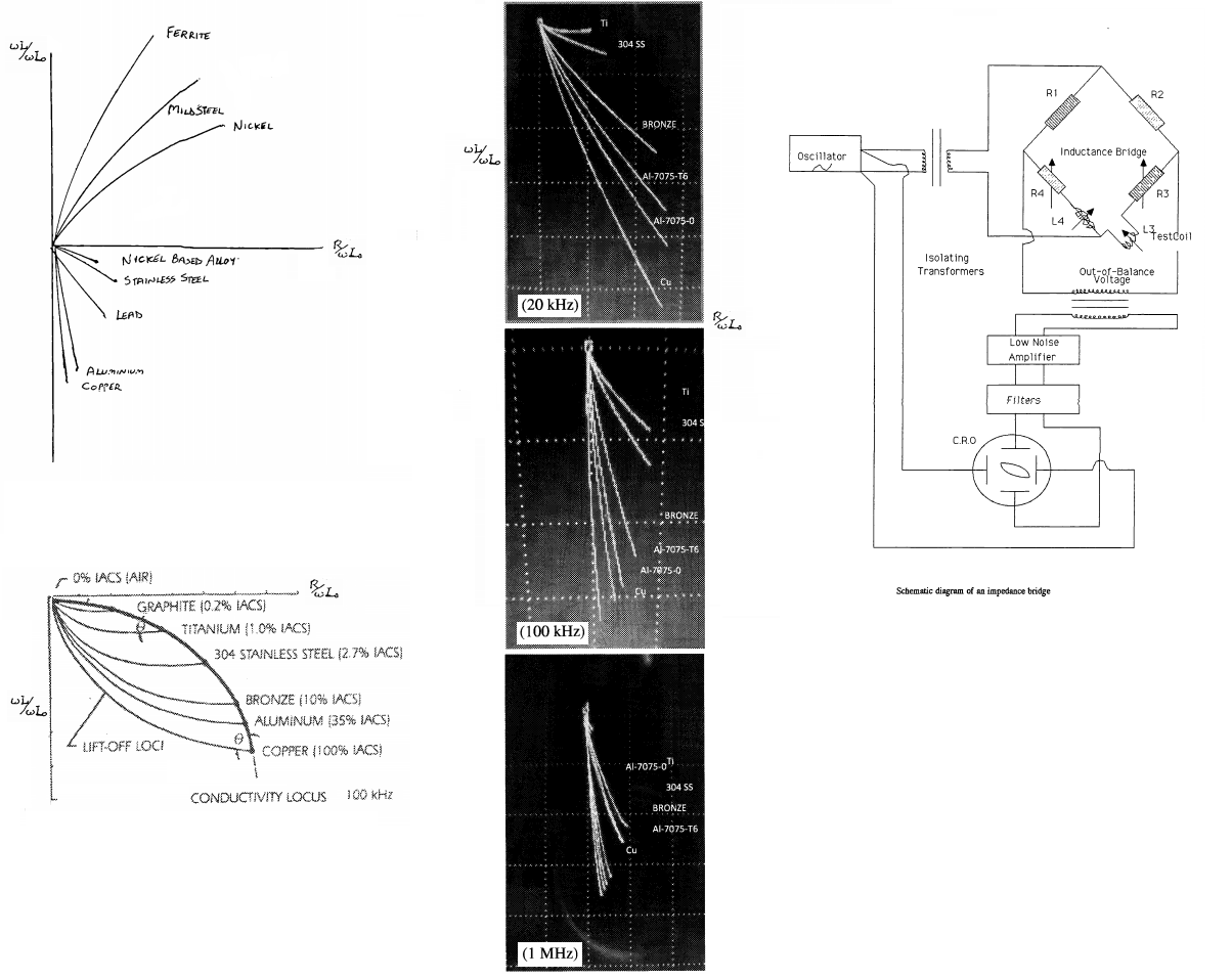

It will be interesting to see what happens when the ring has permeability orders of magnitude higher than free air.
For coil impedance change, see attachment
Origin is coil on air.
Axis values are normalized for coil impedance on air.
This is for fixed test frequency.
What you will measure with a certain steel bar or ring will be totally different when the metal is magnetically saturated (as is the case on the loudspeaker assy) because with the magnetically saturated metal, the huge effect of mag. permeability is being suppressed or vanishes.

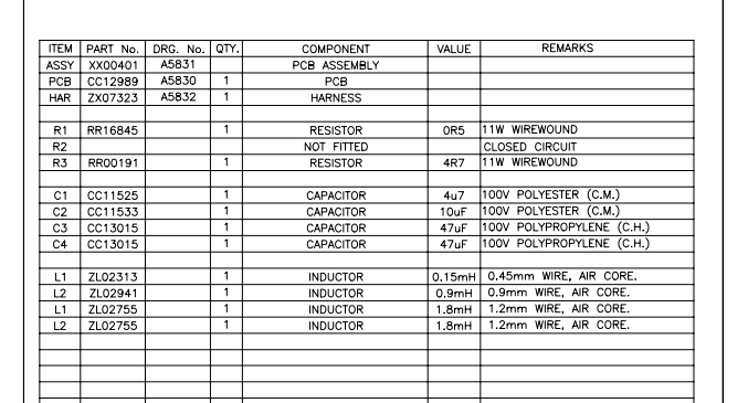

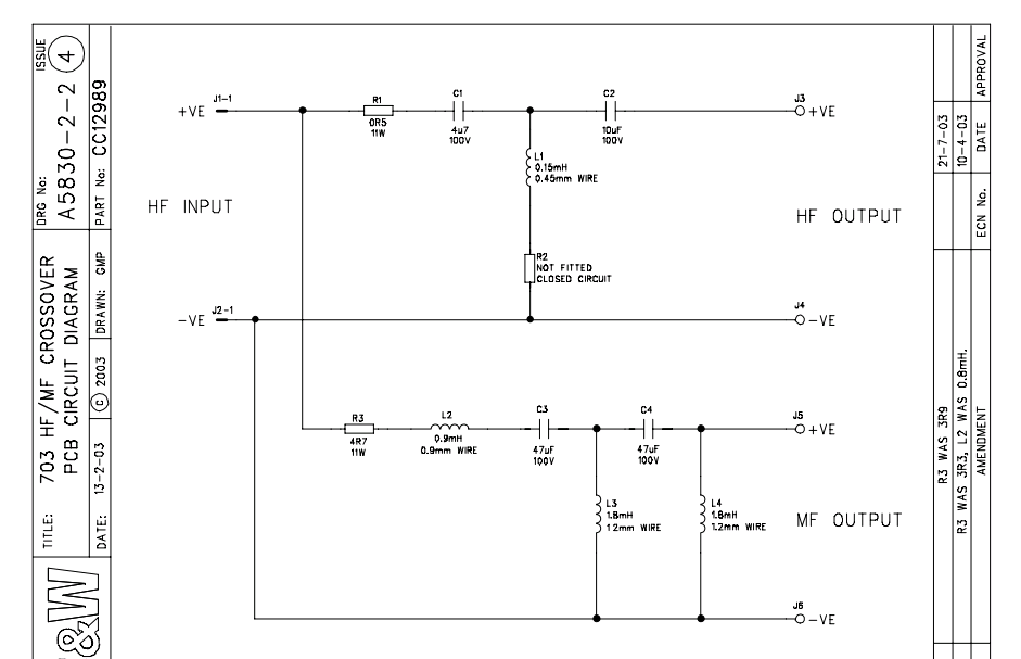

JN, I did a bit of looking to get up to speed of what you are researching and came up with these - Push-pull versus shorting rings and JBL Magnet structures.
A bit more searching and sleuthing came up with these papers which may be of help - View attachment 780530 and View attachment 780531
It seems the first thing to implement is T section centre pole piece and then flux disc on top of polepiece and aluminium ring at the base of the centre pole piece.

I have the 703's discussed in the white paper and love them. I've got a pair of KEF LS50's that sit alongside them and I can quickly swap cables over to compare them.
The 703's sound is big, sonorous, meaty and very exciting on pop, rock and some jazz like George Benson, but the top end is a little too bright for my liking. The LS50's are far more accurate and produce amazing bass for their size - I do use a sub bass for the stuff below c. 80Hz where they drop off quickly though - expected of course because the cabinet size is only a fraction of the LS50's. The KEF's are my go to speakers for classical and acoustic music. That said, I've driven them so hard on rock music that the clipping indicator on my big amp was regularly going off - its set to 56V peak, or 200W into 8 Ohms. I would add, the LS50's don't sing in a big room. Put them in an average size UK living room (say 4m x 4m) and they really come into their own where perhaps the 703's are a bit overpowering.
The 703's are about 89dB efficient while the LS50's are rated at 85dB and its quite noticeable when you swap the cables over - you have to crank the volume up on the LS50's to get back to the same level and vice-a-versa.
I mentioned the bright top end on the 703's to Troels Gravenstein [sp?] and his response was they were deliberately engineered like that because a bright top end 'sells speakers' - he unfortunately had not done any tuning on the 703 (as he has done on some other commercial speakers for private clients) but suggested I try a c. 1 Ohm power resistor in series with the tweeter.

There is one possible scenario that favors a magnetic structure in proximity to the VC (center pole and front plate) that affect the impedance of the VC as much as uniformly across the freq range of operation.
Geometric variations (radial slits) introduced into the magnetic structure will cause complex VC impedance variation with frequency because the ECs in the slitted construction and the secondary magnetic field they produce varies a lot in amplitude (more so at LFs) as well as in phase (more so at HF) with excitation frequency. It is more complex than what happens in the core of an audio transformer, due to the VC movement (variance of EC edge effect)
It is hard to “visualize” the whole outcome with multiple slits, so better start with a single slit and compare electrically and acoustically against the non slitted construction.

That graph looks suspiciously like a flaw detection setup. I had to do some research on how to measure a deposited titanium thin film through a .25 inch thick alumina wall. None of the established methods would work, so I had to invent a different way.
It is.
Impedance plane EC instruments display the real and imaginary parts of the connected search coil impedance. This is essentially the same with what we are doing when we extract the real and imaginary parts from an impedance frequency scan on the loudspeaker coil .
DR. Foerster had developed the EC test theory and did extensive experimentation with encircling coils after the end of WW2. He published in German 1959, then translated in English in "Nondestructive Testing Handbook", Vol.II (ed. R.C. McMaster) Ronald,
