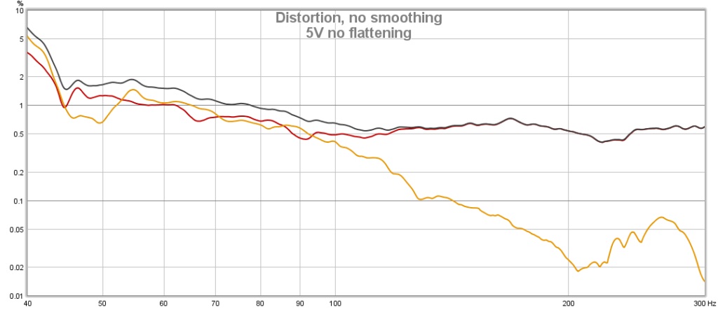

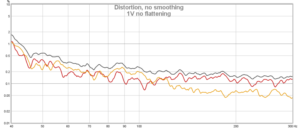

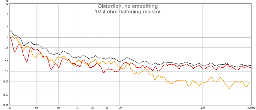

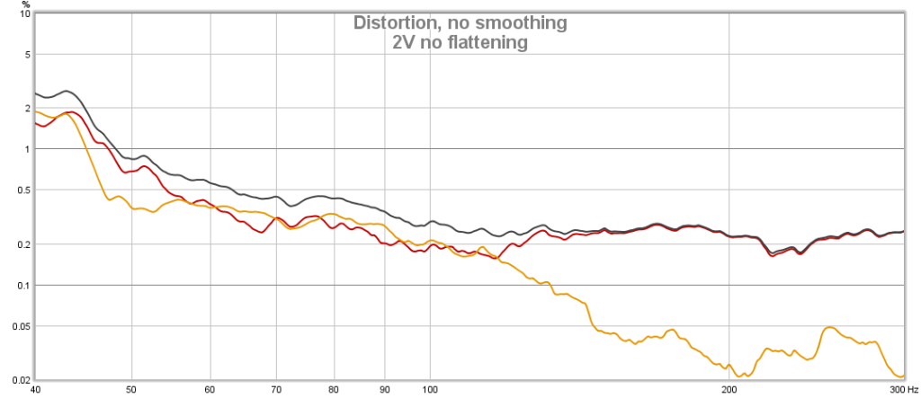

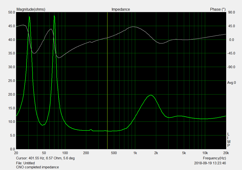

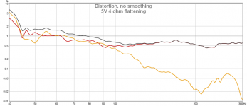

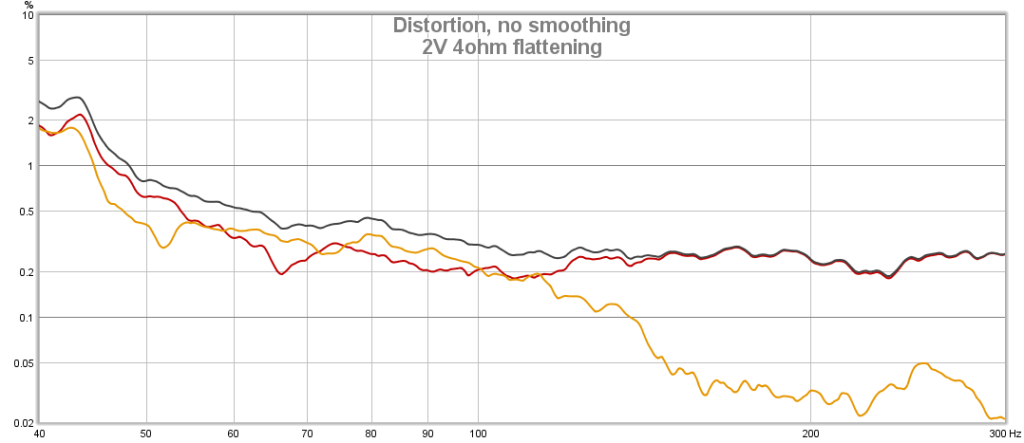

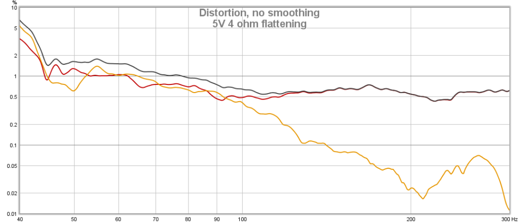

A scientific method requests for independent verification of new findings by replication of the experiment at a different work place. Joe, I will measure speaker distortion with and without impedance flattening.
OK, I did it 🙂. As a part of another measurements, it was no problem to add a "flattening" resistor of 4 ohm.
Attached is the impedance plot of the speaker. One can see that impedance near resonance goes up to 47 ohm and that it remains above 6 ohm everywhere. So, with 4 ohm "flattening" resistor the impedance will be between 2.4 ohm and 6.4 ohm, values including resonance.
I have measured speaker acoustical output at 15 cm distance from woofer, on woofer axis. At 1Vrms and 2Vrms and 5Vrms amplifier output. Distortion plots are shown for both cases, i.e. no flattening resistor and 4 ohm parallel flattening resistor. The distortion is not changed after "flattening", in other respect than acoustical measurement statistic deviations. So - nothing 🙂.
P.S.: Amplifier distortion was below 0.01% in all measurements

What are the three colours of the graphs and what is the speaker crossover schematic ?.
Dan.
Three colors are THD (grey), H2 (red) and H3 (orange),
The full conditions are not defined so no conclusions can be drawn yet. Also did Pavel not state earlier that adding parallel resistor will cause increase in distortion but now says "The distortion is not changed after "flattening".
Dan.
Yes, however it was said about amplifier output distortion. As this is much much lower than that of the speaker, acoustical distortion is unchanged.
All those stories about impedance flattening may be related to some tube amplifiers with high output impedance, to some extent. For SS amplifiers (not speaking about some curious non feedback designs) all the stories about R, RC helping amplifier to deal with EMF are simply a big nonsense.
A pleasant coincidence right after asking you yesterday. Thank you Pavel.
Looks to me like Black is THD, Red is 2nd harmonic and yellow is 3rd.
Thank you, I am sorry I forgot to include the legend in the image.
