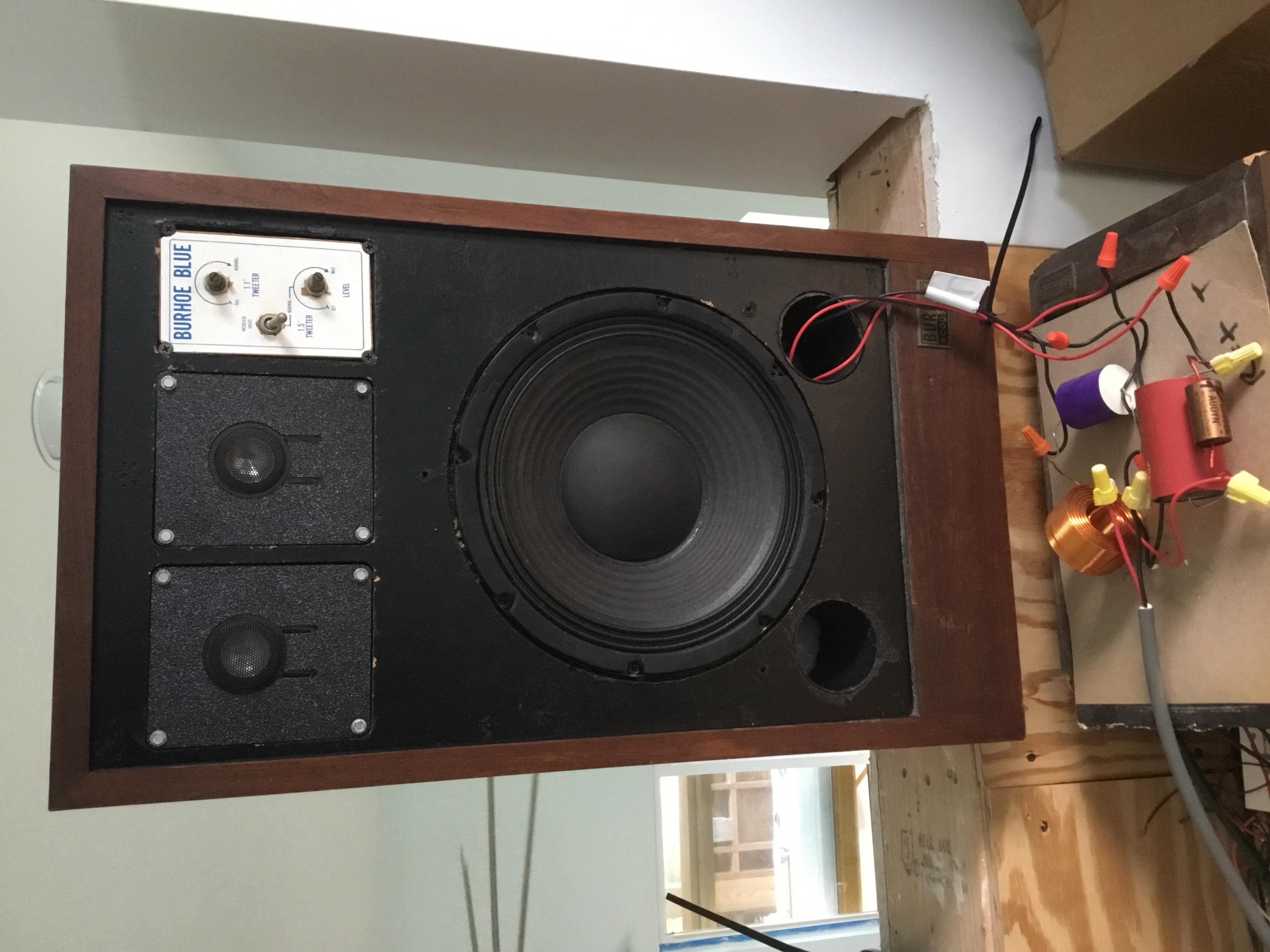

Speaking of distortion cancellations.......is there anything like that going on when you go from one tweeter to two on the same baffle? I know combing effect is there but is there anything that would result in a cancellation of distortion.....because it sure does seem that way.
Awhile go I blew one of my 8ohm tweeters (6.7 measured) and i tried my 4 ohm (3.9) spare tweeters and the xo shift was too drastic, so having four of the 4ohms I tried wiring two per side in series just to ‘see’.
The results of combing is evident but just enough to add dimension to the sound stage....rather nice. But the big thing is the sound is now smoother and clearer?
And the thing is these tweeters were of lesser sound quality than their predecessors (when crossed appropriately) in single use.
I did end up having to chase the phase around a bit and ended up having to turn my sub xo down from 60hz to 40hz.
Jury is still out whether or not this is a good thing?
Any ideas? Here’s a pic.

Nice point to point wiring, genius class and the most pure sound that you are ever going to get, nice.....(no brass, nickel, lead). Two tweeters/half travel makes for lower distortion, and maybe the new tweeters are not so bad after all ?.
Yes never thought about the half travel......good point.
I’ve been called a lot of things but genius isn’t one of them 😀
I tried soldering the same setup and it was quite dull sounding, I couldn’t figure out why and asking on another forum resulted in the typical bs or ‘it must be wrong’......wire nuts are easier than soldering anyhow!
