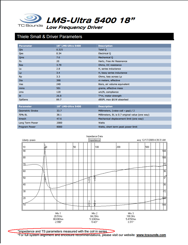

@Richard, I am most interested in your drivers that makes Walys head spin. What are you using and how are you configuring it, them?
Gentlemen enjoy the ride.
They are TC Sounds 18 inch drivers. Maybe not available any more... so expensive to make.... 50 pound magnets each. Model LMS Ultra 5400 dual voice coil.
Probably a compound- isobaric-push-pull 3 chamber-bandpass filter thing.
Not.
Just simple sealed enclosure of suitable size to keep GD low. Since they are low distortion etc, I can use just one driver per side.
THx-RNMarsh
THx-RNMarsh
Just for my interest, do you have an idea why they don't use Neodymium Magnets, which would be smaller in size an lots more efficient.
I am aware abouth the tempco making problems 80 deg C and up, but when very efficient there would be significant lower thermal load and i am also aware that Neo's are expensive an on the other hand they can be much smaller compensating the price partially.
Thanks for taking your time to answer if possible.
regards Frank
