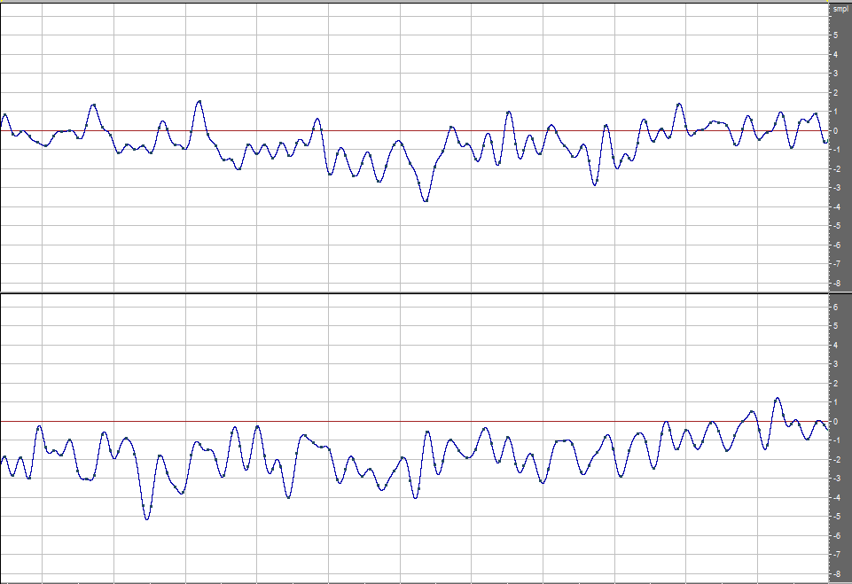

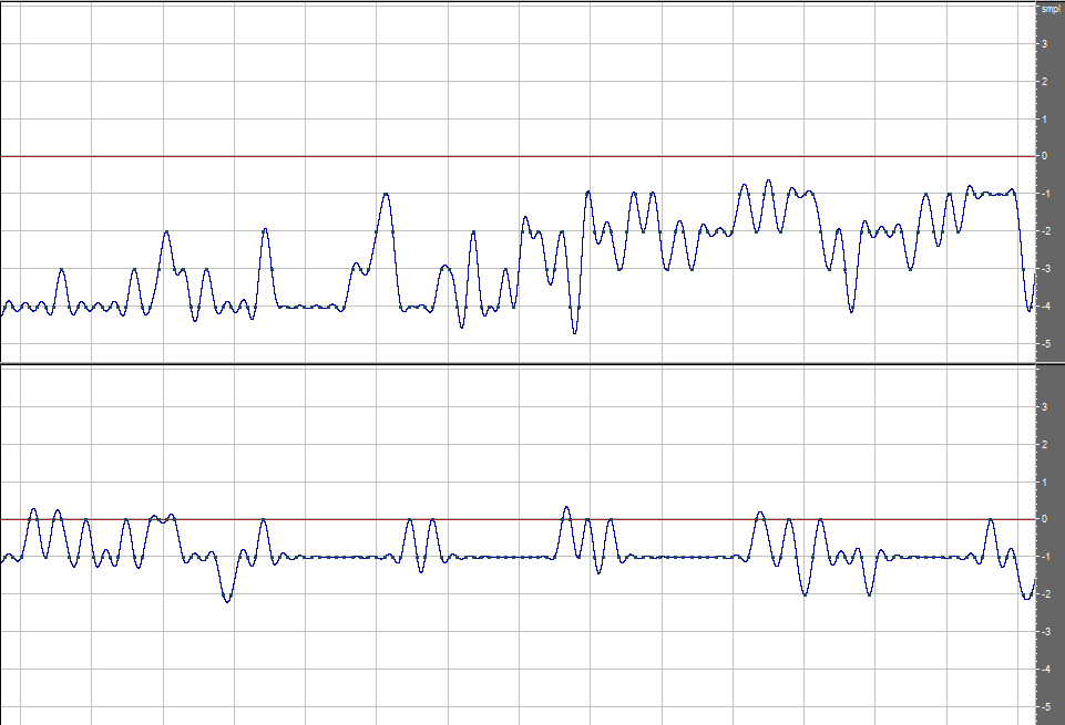

Not sure what goop does (they actually sound basically the same) but am more concerned about what you did. I was curious about why the two files had very different compression ratios so I examined the noise floor of each. First of all the one on the right is clearly 16bit and the other 24bit. Besides that the first one is improperly dithered and long runs of the same number are present leaving a residue of 16bit undithered behavior. I would not use these files as a test of anything.

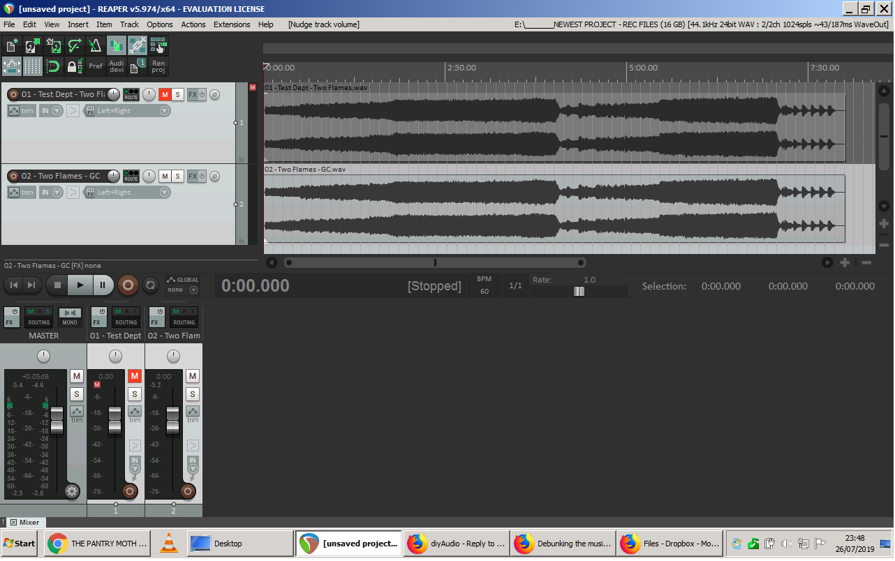

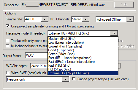

Ok, my original files are 16bit and my USB soundcard/ASIO runs 16bit pb/rec or 24bit pb/rec so if I want 24bit loopback recordings I need to pb 24bit source files. My method has been to load 16bit source files into Reaper and render/save as 24bit files with no dithering (dithering choices are not available?). This 24bit file was then reloaded and used as the source file of the loopback recording.
Should I be doing this 16bit to 24bit conversion differently, ie different menu choices or different software ?.

This particular test is about recording the sound of a usb soundcard in loopback mode in combination with recording the sound of one particular cable and comparing that sound with the sound of the source file that was used to generate the loopback recording. Does it actually matter that the 16bit depth of the original is played back in 24bit format with no interpolations ?.

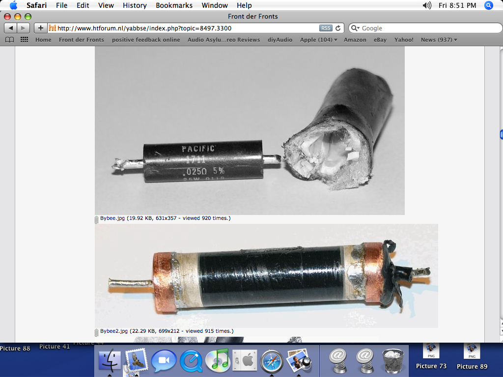

Here is an inside picture of what Dan is referring to. The best explanation for its action I put up a few days ago, written up by another physicist. Good reading, I think.
