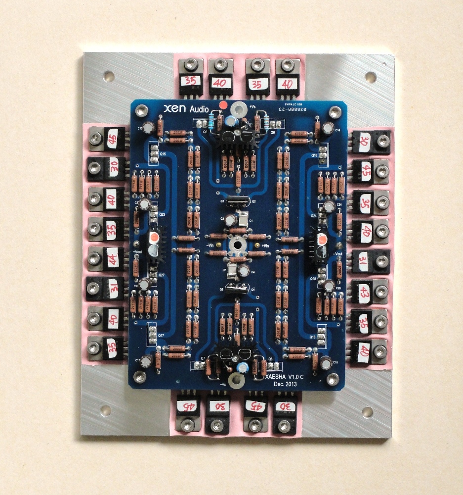

My still-under-construction +/-400V XAESHA based on Blowtorch topology, 82W
(See photo).
Patrick

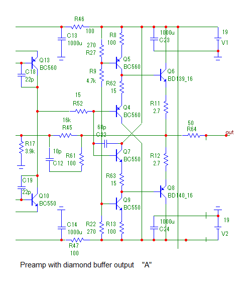

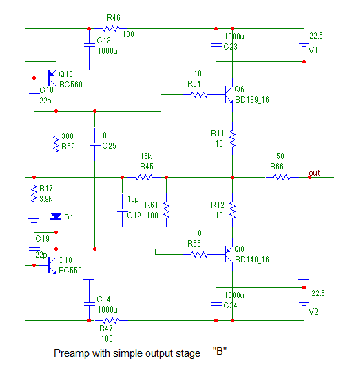

However, something strange happened to me. I was measuring 2 preamplifiers, with basically same circuit design (complementary differential JFET input + folded cascode VAS + output stage) which were different only in the output stage circuit.
Preamplifier “A” has a diamond buffer based output stage, with output impedance 50 ohm (series resistance).
Preamplifier “B” has a conventional NPN-PNP simple EF output stage, with output impedance 50 ohm as well (series resistance).

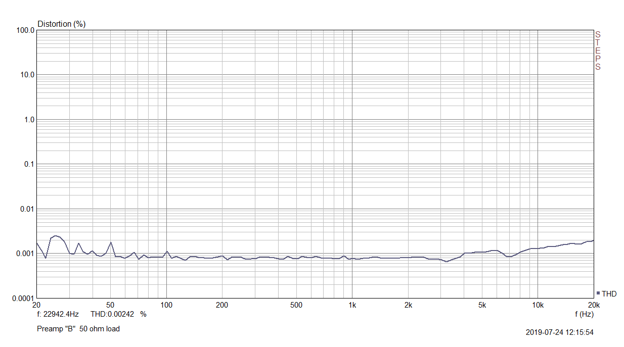

Both preamps measure almost identically into 10k resistive load and both are able to drive 50 ohm load with low distortion, “B” being little worse but still keeping THD in order of 0.001%.

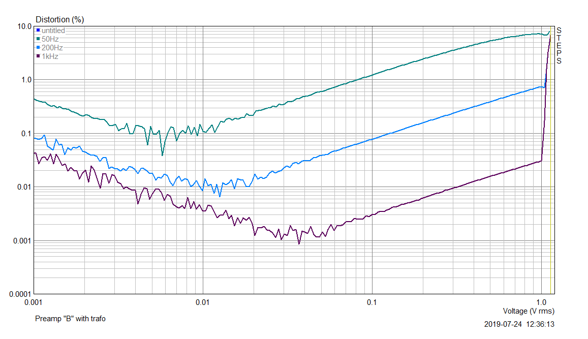

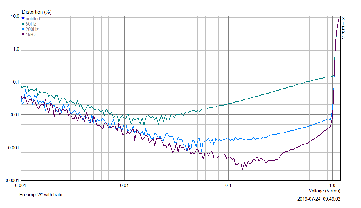

Now, I tested both “A” and “B” with a link level output transformer, which a primary Rs = 40 ohm, Ls = 4H, secondary Rs = 70 ohm and secondary Ls = 4H. This transformer has of course increased distortion at low frequencies and I have measured it dozens of times.
But, what happened now. Though preamp “A” shows “standard” distortion plots with the transformer, preamp “B” has enormous rise of distortion numbers. A reminder, it drives a resistive load down to 50 ohms with no problems.
Attached are circuits of output stages “A” and “B”, measurements of distortion (at 50Hz, 200Hz and 1kHz) into link transformer with preamps “A” and “B” and also a measurement of the suspicious preamp “B” into 50 ohm resistive load.
Anyone with a meaningful explanation?
