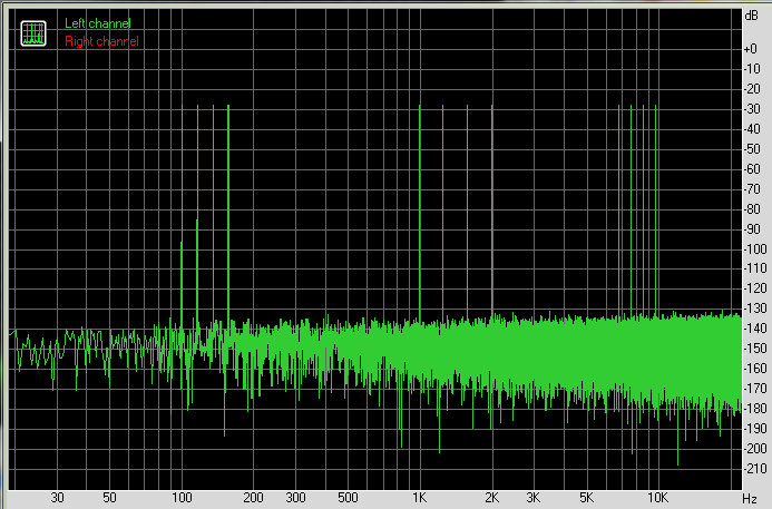

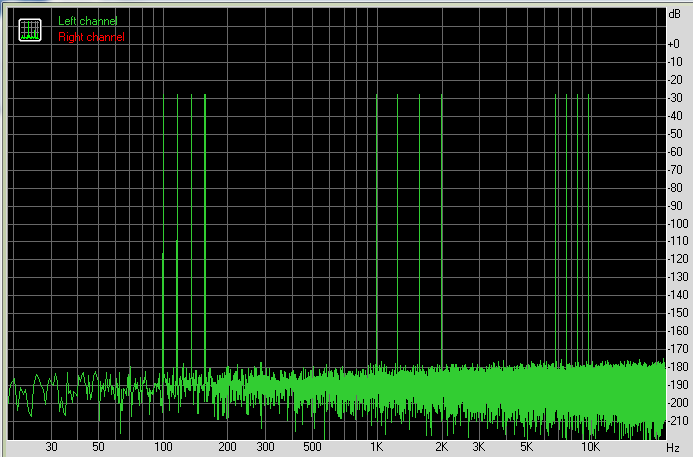

Demian’s triband test file, adapted for 44.1kHz sampling rate systems and 64k FFT length testing, no window function.
(mono wav, 44.1kHz/24bit, 1min long)
Dropbox - L+M+H (-6dB_44.1kHz-24bit).wav - Simplify your life
(mono wav, 44.1kHz/16bit, 1min long)
Dropbox - ditheredL+M+H (-6dB_44.1kHz-16bit).wav - Simplify your life
Freq:
100.264, 116.414, 135.255, 156.789
987.163, 1245.561, 1571.251, 1983.073
6764.790, 7618.716, 8579.636, 9662.352

It does seem very well behaved so it makes me wonder what sort of fluctuation might be seen in that noise floor with a changing multitone test signal?Demian’s triband test file, adapted for 44.1kHz sampling rate systems and 64k FFT length testing, no window function.

I understand making the frequencies such that no IMD tones are in the bins with the test signal, but I don't see the point. In any case you can rotate the phase of these tones to vary the crest factor, with 1V tones the peak is 12V at 0 phase and with some fiddling you should be able to get the peak below 2V. That's a nice 6 to 1 range in crest factor.
Superposition does not apply to a non-linear system, the crest factor matters to the distortion result.

Isn't the point exactly that "no IMD tones are in the bins with the test signal" so no confusion between test signal & IMD? I know you know this but can't understand what your point is?
Just saying that any multi-tone test has empty bins that fill up with "grass" which I assume is what we are looking for. Assuming the test tones are much larger than the IMD there should be no confusion.
