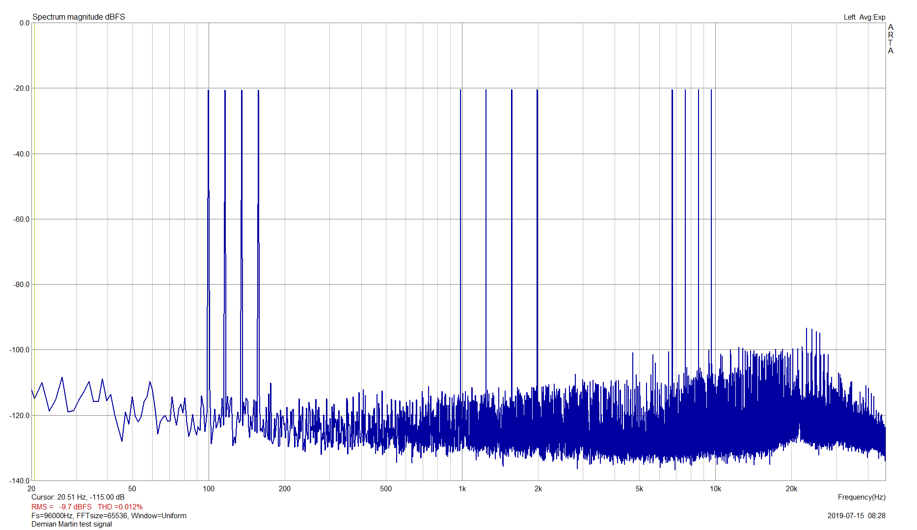

Demian’s triband test file, adapted for 96kHz sampling rate systems and 64k FFT length testing, no window function.
Dropbox - L+M+H (-6dB)_96kHz-64k FFT).wav - Simplify your life
(mono wav, 96kHz/24bit, 1min long)
Freq:
99.609, 117.188, 134.766, 158.203
987.305, 1245.117, 1570.313, 1983.398
6764.648, 7617.188, 8581.055, 9662.109
George
That's a good test signal, thank you for a reminder, George.
George

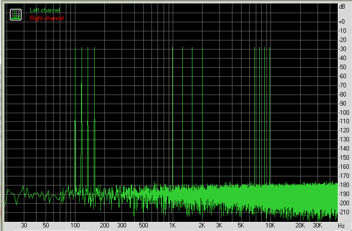

Is the plot digital or DA-AD? I see no artifacts above -170 dB? Does ARTA have a peak hold on the FFT?
I tried the file on some of my hardware and I'm getting odd results. With two different AD-DA and two different software packages I get flawless digital loopback and really substantial frequency response errors on analog loopback. I will setup with different hardware tomorrow if I have time and then post results.
It looks like signal analysis, not D/A - A/D.

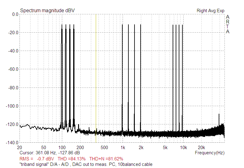

I am attaching the "real thing", mediocre one.
In both posts (post 24976 for the 48kHz SR and post 25131 for the 96kH SR) the FFT screenshot (65536 samples, no window) is from the digital test file.
I will try to build another test file for 44.1kHz SR systems.
Card Loopback and systems tests are for a later time.
George
